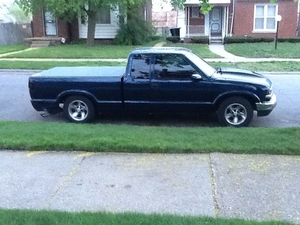

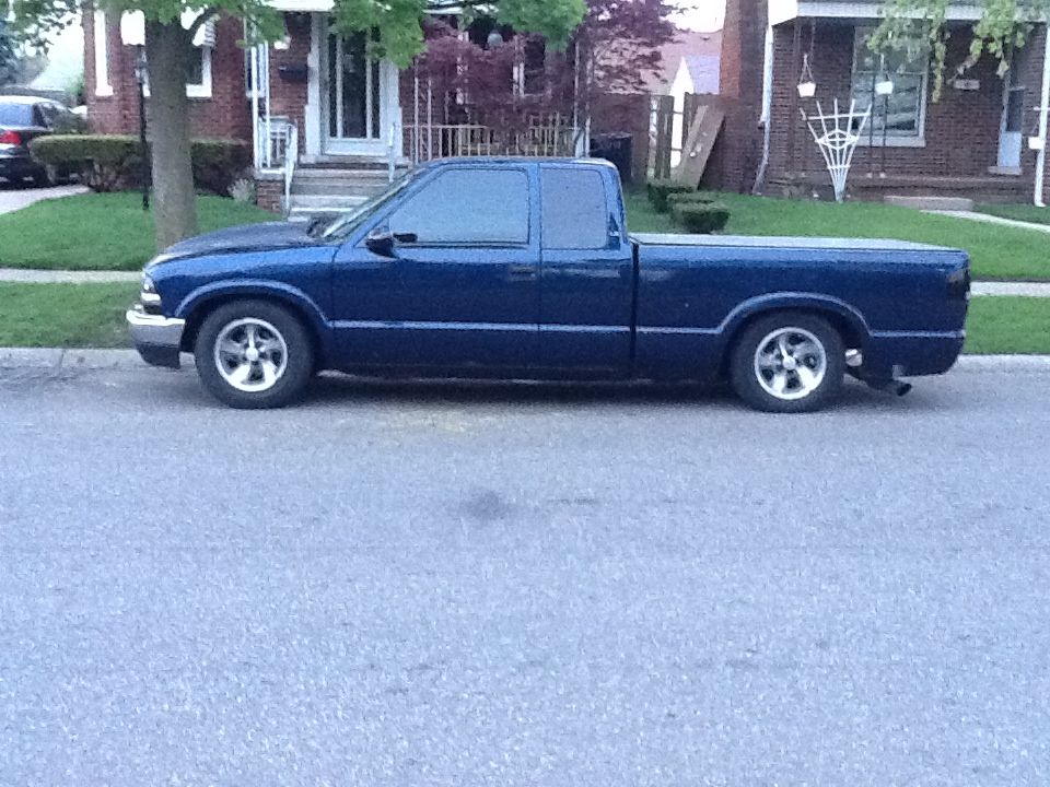

Had just about all my steering components replaced today, along with upper control arms, i have tubular arms on my truck now, i have 3 inch blocks in the back which made a big difference. My truck is a ZQ8 so its already lowered 1.5 front and back but what gives because the front is still higher than the back, my drop should be a 3.5/4.5?? Is still looked like this before the 2inch drop spindles, and still looks like it after

Post some pictures up of your setup.. take wheel off and take pics of these drop spindles.. and the base of the lower control arm where the spring rides so we can see whehter it is right or not.

Is it just me.. or does those spindles still look tall on the top side??
