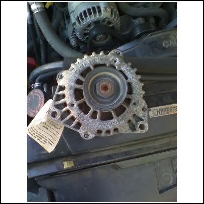

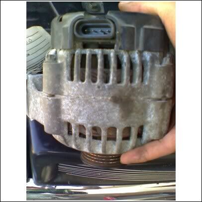

*The AD244 alternator will bolt right up to the stock alternator bracket on the 4.3L with NO modifications to the bracket. The only thing that is different is that you won't be using the 3rd bolt that is on the backside of the alternator. The CS130D has this, but the AD244 doesn't. You won't have any troubles with the bolt not being there.*
*The AD244 uses the same wire harness as the CS130D. It is a plug-and-play application.*

Here are some pictures of my AD244 in action:

Regarding to the DR44 and DR44G alternators more commonly found on the newer GM trucks, besides having the two pin regulator connector.. another major difference with this unit compared the the AD244 alternators is that on the DR44 and DR44G the bridge rectifier is embedded and fused into the rear casing to form one single part where as on the AD244 the bridge rectifier is completely removable and upgradeable.
Standard on the DR44 and DR44G are 50 amp diodes in the bridge rectifier and double wound stators which is the same as in the AD244, however the on the AD244, the bridge rectifier can be easily replaced with one that utilizes much larger rated diodes (up to 70 amps). This makes the AD244 much more versatile and durable from a rebuilding standpoint.
With slight modifications, the 2 pin and 4 pin voltage regulators on these two units can be interchanged with one another. This is more so a mounting modification as there are some slight clearance issues.
In my opinion, it would make more sense to just get the older AD244 units versus the newer DR44 and DR44G units.
However, if you already have a DR44 or DR44G unit and want to be able to use it in your older vehicles that uses the 4 pin connector, it would be much easier to just replace the 4 pin male connector with a newer 2 pin male connecter and wire it appropriately (local scrap yard has plenty of connectors). Check with your local alternator guru for proper wiring. I believe there are some connector adapters/converters available that would be able to accomplish the same as well. This might be easier and cheaper than taking the alternator apart to replace the voltage regulator.
