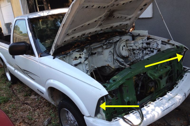

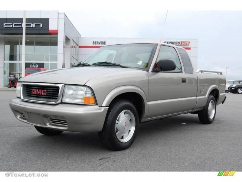

I hit a deer going to work and damaged my front end. I like the look of the s10 front end. Is it possible to convert?
Sorry if there is a thread on this already!!
Current Front end:
Desired Front end:

They're pictured like your looking dead on at the truck,so its left is to the right of the pic..
They hold in with built in Christmas tree style push fasteners.
Oh! And my list was missing the bowtie!!! AND the hardware for the lower valance,AND grille clips!! If OP buys new/aftermarket those are not included!!
AND THAT S10 OP POSTED HAS AN AFTERMARKET GRILLE!! the bowtie doesn't fit correctly in aftermarket grilles!! It's instantly noticeable,and looks like shit! I see on several members trucks,but it looks like shit on all of them! I'm being nice when I don't point it out,lol
