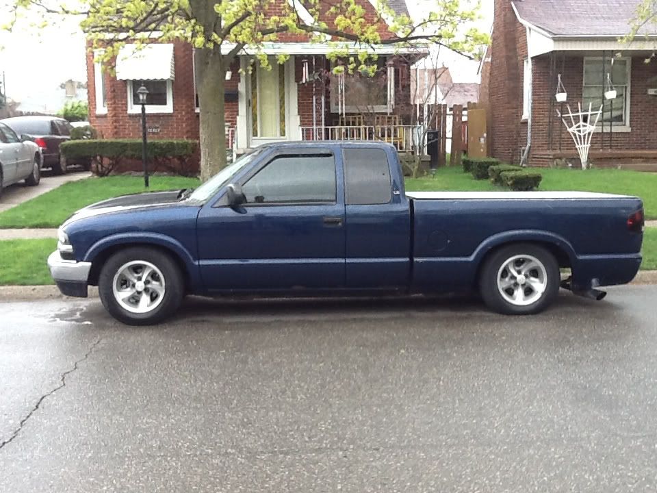

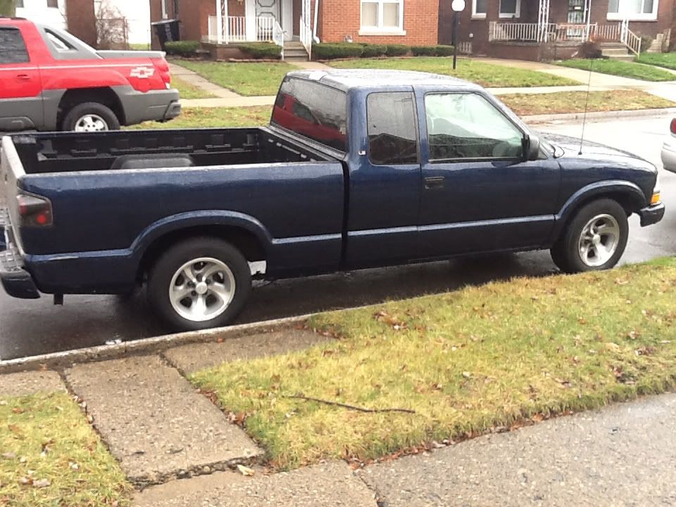

Had just about all my steering components replaced today, along with upper control arms, i have tubular arms on my truck now, i have 3 inch blocks in the back which made a big difference. My truck is a ZQ8 so its already lowered 1.5 front and back but what gives because the front is still higher than the back, my drop should be a 3.5/4.5?? Is still looked like this before the 2inch drop spindles, and still looks like it after

Yes from TSS, that would really suck if they sent me the wrong spindles because it looks like it didnt get lowered AT ALL when the were installed, heres a pic from 2weeks ago, this is how my truck looks wth just 3inch blocks on top of ZQ8 suspension. You really ant tell a difference at all!!! Ireally dont think tire size would make that big of a difference would it? But like i said is there anyway around this, like if i went with a staggered rim setup?

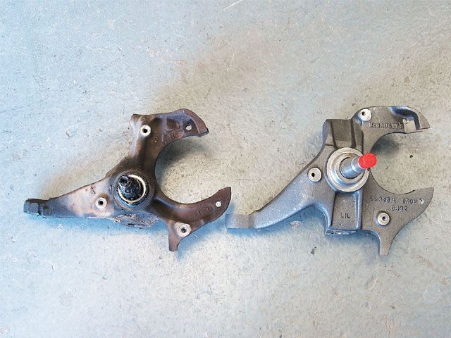

Yeah IKR!! No i dont believe so, they looked like the stock chevy spindles! Yeah they definitely looked like the spindle on the left (stock spindles did)

I let the guy that did the work keep them... Man what a pain in the ass this is starting to be.. I swear everything i attempt on this truck makes sure it stesses me the hell out, i dont think ill be investing another dollar into this POS, im eally upset about this crap man! But even if they were drop spindles it still wasnt at the correct height anyway, the front should actually be lower because thats how it was setup stock.. Theres usually a slight rake on stock trucks, look, this is how my truck was BONE STOCK with no lowering parts on it, front is lower....

OK. Lets back up a minute here. You showed us a picture of stock next to 2" drop spindles. Are these THE spindles in the truck now? Since the front is definately no lower, you need to figure out why Before you spen all that money on wheels/tires. Don't skip over the spring clock possibility. Also be sure, as in dive under the truck and look. I say this because I'm an old guy and I forget shit all the time. Just cover ALL possibilities first. :rolleyes:

if i were you i would just take everything back apart up front just to make sure you got all the parts "actually" installed that your installer said was installed. it looks like in the pics to me that it looks like the drop spindles were not put on. Or if they are and you need to move your spring and yes you would have to take everything apart again to do it properly.
