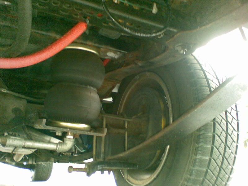

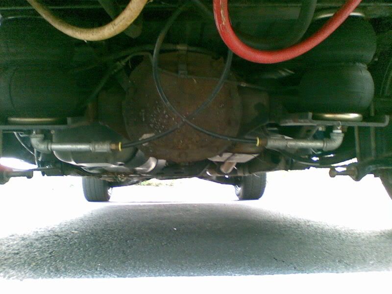

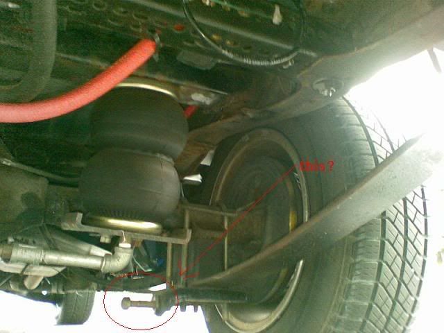

yo whats up every one...my truck (99 sonoma) is baged with no shocks im shure some of you know what thats like..it sucks!...so i need to get some soon as i can..i just dont know ware to start with this..what type?..what size? how to i do the math to know the rang of the shock?...etc..and some one told me that i dont need to do the frunt he said just do the back?..what do you think of that?....thanks!!:D

its monoleafed. im only running shocks in the rear. and to figure out the range, i found where my mounts were gonna be (upper and lower) and layed the truck out and measured the distance. and add an inch for safety. then do the same with it aired up. add an inch for safety. then go get them ordered. as for brand, i had monroe.

toxic shocks are really stiff. id go with the hard body shocks bought mine at autozone for like 15$ a piece.

ok then toxic is out...and 15 bucks is the kinda money i have haha so il probly go with that....i traded my old car fot the truck i have now and it came baged and im just redoing it slowly so it came with no shocks il look and see it the mounts are there if thay are will that work? with it being baged i mean

shouldnt matter where you put it. Just make sure it doesn't limit your suspension travel up or down. and check where you are gonna mount it when the truck is aired up and layed out, so you know nothing will get in the way. Spend 20 minutes and take the 8 bolts off that hold on the bed. Get an extra guy to help you lift it off. The job will be way easier once you can see everything!
