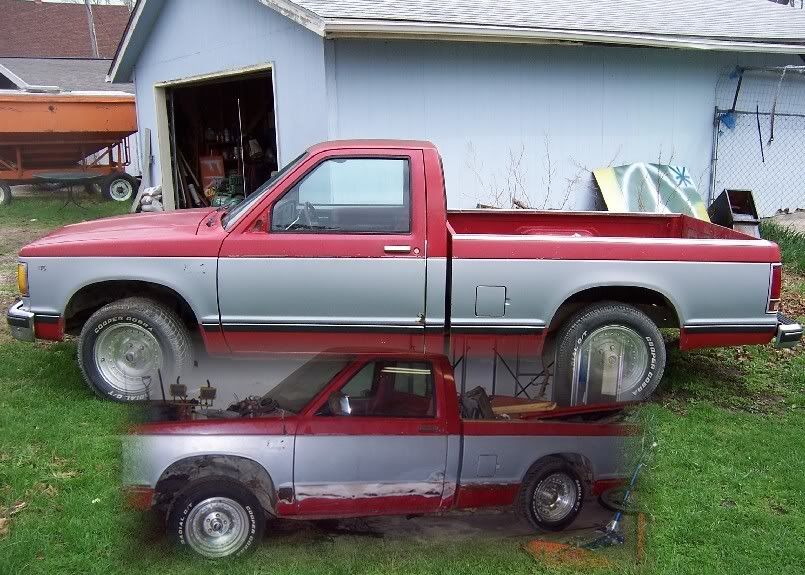

I got a drop kit from a friend. 3" lowering blocks and supposebly 3" lowering coils, and it looks higher than before, even with a v8 and th350 instead of the 2.8. maybe it's because i dont have the front end all together yet, but i dont think that will lower it too much more.
http://i189.photobucket.com/albums/z212/youngfighter_43/1.jpg
#8 ·
ahh now that i really look at it i see the rear is a hair lower now. Make sure you set the front springs in right. They have to sit correctly up top and bottom ... I had that issue. up top they have to go around this piece that looks like a C if looking from directly below it. The C will sit down about an inch or to .. it holds the spring from moving.. the bottom has something to do with the drain holes. which i dont completely understand yet..
#27 ·
did you measure before and after fenderlip to center wheel?
being 1st gen your stock coils can be worn that even with 3" drop coil, doesn't drop further from where it was stock
#22 ·
Yikes! The front-end of that looks almost as high as mine does with the 3" body lift!
The rear looks good in the latest pic, though ... although, would that have anything to do with the weight of the stuff I see sticking out of the bed?
