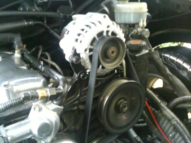

*The AD244 alternator will bolt right up to the stock alternator bracket on the 4.3L with NO modifications to the bracket. The only thing that is different is that you won't be using the 3rd bolt that is on the backside of the alternator. The CS130D has this, but the AD244 doesn't. You won't have any troubles with the bolt not being there.*
*The AD244 uses the same wire harness as the CS130D. It is a plug-and-play application.*

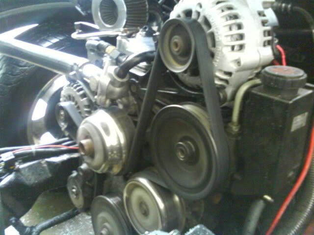

Now that you have the alternator, you'll be needing a longer belt. I can't say how long of a belt you'll be needing, but the stock one won't work. If you DO get the stock belt to work (some have) I STRONGLY don't recommend it. It will put a bigger strain on the bearings in the alternator and can cause premature failure. It's worth the extra $35 for a new belt.
*You will need a belt that is 1"-1.5" longer than stock. For some reason, the lengths of belts changed from year to year (even 98+) so you'll have to do a little bit of math and figure it out on your own :p *

First I did the AD244 to my 97 S10 4.3l - works just like it should!
This is all for a 1997 S10 - others may/will vary.
Got mine from a salvage yard and it is a genuine Delphi 145A has the engraved ID. Took it to Autozone and had them check it, it passed. That way I could take it back and replace it if needed. No need to try it on my truck and find out it's condition.
The belt issue - I had in the past few months replaced mine so it was a good belt, the AD244 fit, though the tensioner was tighter than I liked.
So I got a smaller diameter idler pulley from Autozone a 231098 for $11.99 (Dayco #89098). It worked and the tensioner is right in the middle of it's travel. Told the guy I needed that part number, he asked what it was for, told him riding lawn mower deck, they can't look that up!
The standard pulley is 90mm (3.54in) in diameter. The 231098 is 76mm (2.99in) in diameter.
Want one even smaller try the Zones 231052 (Dayco #89052) $14.99, it is 70mm (2.75in) in diameter. Can not say this will fit as I have not tried it.
Note that the tensioner pulley is 70mm in diameter if your thoughts are that a 70mm will be too small.
Changing the idler pulley was cheaper than replacing the belt.
Then I thought about the belt issues that some folks are having and I wonder if the idler pulley on their trucks is the correct size or not?
This is another way to fine tune the belt tension if you feel the need.

im gonna have to revamp my reply to this. everything is right except the belt.
i tried one size bigger gatorback belt. while engine was not running, the tension marks were just barely within spec marks. when engine was running, the belt was too lose and outside tension marks or tension pulley.
with a couple cuss words, i was able to get the new OEM size gatorback belt on. when engine is running, it is perfectly centered on belt tension marks for the tension pulley.
basically, you cant go by what looks or feels right. go by the tension marks on the tension pulley, WHILE ENGINE IS RUNNING.
