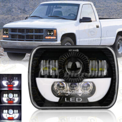

I have a 91 S-10....4.3 ...it's been in the family since new.
I need brighter headlights!!!! Maybe I'm just older or.......maybe the wiring is older or.....
Does anybody make LED style headlights?!
Would running relays to the headlights be the answer??
Really rather just swap headlights....
Thanx

It appears in that link that the same company has a newer brighter LEGAL headlight pair for only $10 more.
The important thing on either is that they are approved for use on the highway. Many cheap ones tend to not have a proper cutoff and the glare blinds oncoming drivers which could get you a ticket even if you don't care about others.

Can’t say anything regarding the “brighter legal” light, mine are indeed legal, with clean cutoff lines so no blinding traffic. The set in my link I have real world experiences with, for years, they are bright, many times so than the Silverstar Ultras they replaced. Do you have any experience with the lights in your link?

No, I don't know a thing about them. They were on the link you posted, as a newer version of the same light by the same company. Not trying to burst your bubbles. Simply pointing out that in 2021 the same company started selling a new improved, according to them, version. Sorry for trying to be helpful.

I bought a pair of these off ebay. They are bright
#6 ·
These are more expensive, but Holley sells some Morimoto headlamps that don't look like garbage, actually look like normal headlamps.
