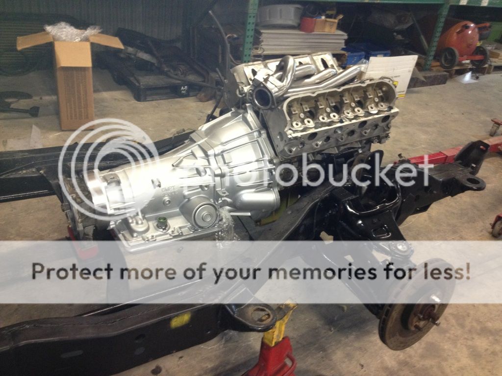

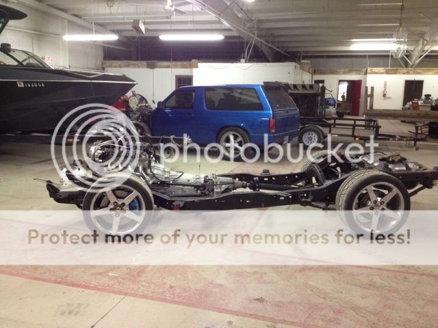

Im building an all wheel drive chassis to go under my currently 2wd blazer.
A few nights ago, I sat the trans and engine in to chk some things, this is what I ran into:
The engine is sitting way over to the pass side. Looking at the mounts, looks like .750" or so, but looking at the center of the frame, it needs to come over more than 1.250"....
The pan is touching the diff! So is the pan rail. I can trim a little off of the block too.
As it sits, the passenger side header is way off on fitment. Is it possible to lower the front diff .250" or so, I know I can raise the engine up a little too. Im using the Sanderson shorties and mounts from Current Performance. The frame is from an 85 jimmy.
Aside from the pass header not fitting, what other isssues could I have from the engine being off centered? And is it possible to lower the front diff???

I suppose its possible Are you using the CP mounts? I should have 4-5 hours tomorrow to try to manipulate it all... somehow.
My plan for tomorrow is to try and adjust the motor mount pads up on the frame, and possibly shim between the cradles and block for some height. Also gonna cut the boss off of the block as acehaag mentioned. Maybe somewhere in there I can Drop the diff a tad, or maybe scoot it to the driver side a hair. Hopefully I can do all of that and get in a test fit with the old body.

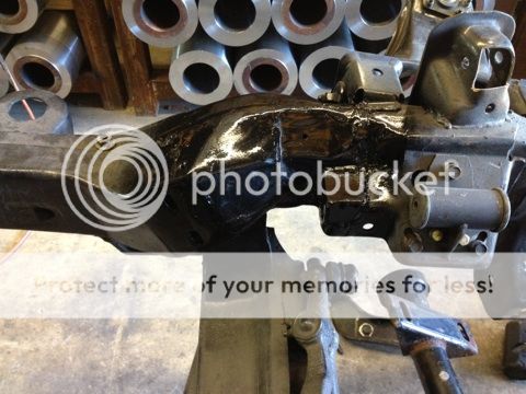

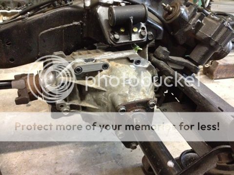

So now my busy work season is over, Im back to work on my awd swap! Finally got my engine sat where it is centered in the frame. I ended up dropping the rear mounts of the front diff by a little over .250". I just chopped off the ears for the rear 2 rear mounts, welded them back on, and re drilled new holes in the frame mounts.
I also took a little off the front diff, and countersunk allen head bolts in the case.
That and a little "attitude adjustment" on the oil pan allowed me clearance with the engine sitting nice and centered!

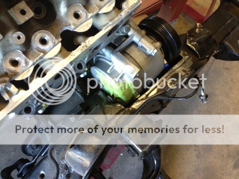

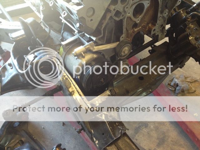

I am using C5 vette brackets... Turns out the ac compressor is a lot bigger than the truck compressor... I tried notching the frame, with no luck.
oh well, I put the pieces back in the frame, I'll be ordering the top mount compressor...

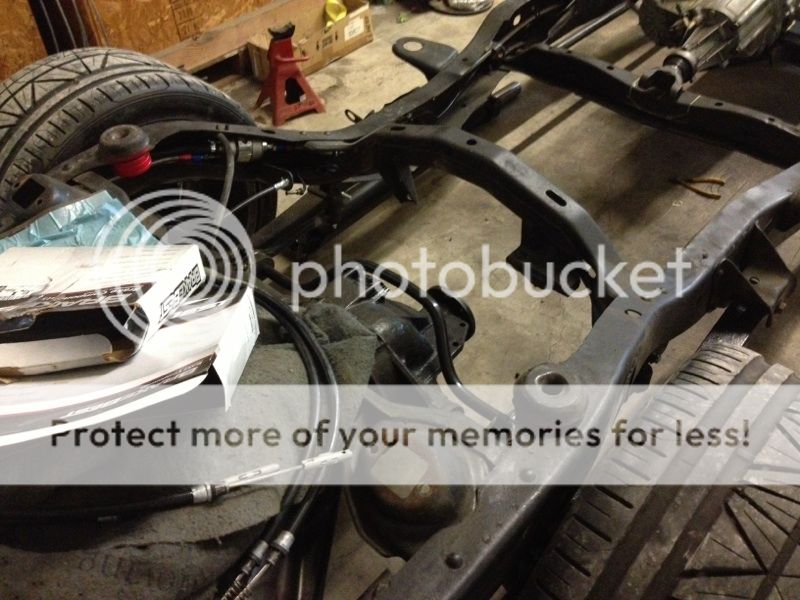

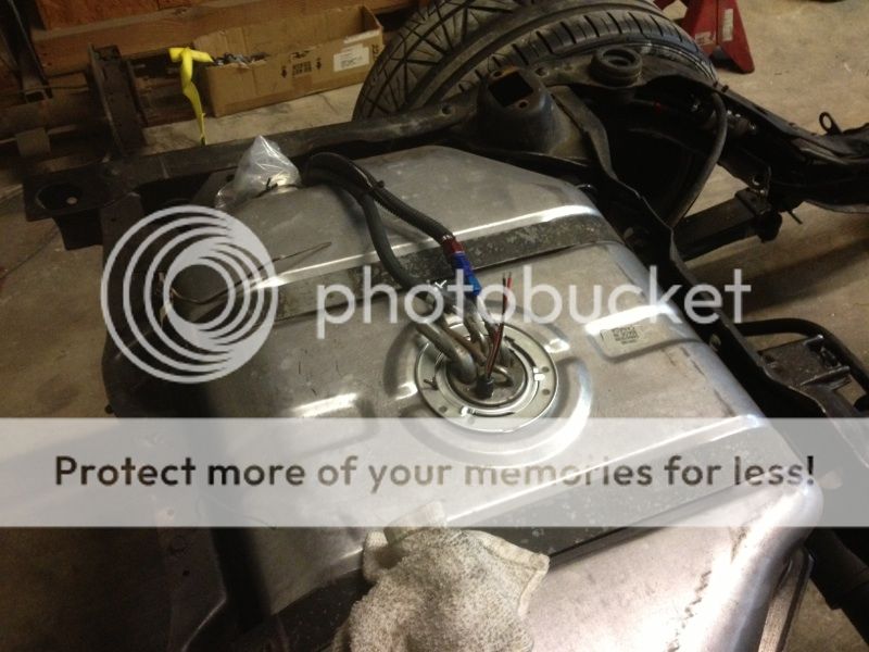

So its been a while, but I have made some progress... Not a lot, but some! Got the ford 8.8 and sway bar in. Fuel system mostly done.
Still waiting on the rest of my upper control arms to be done. Just the parts for the buschings.

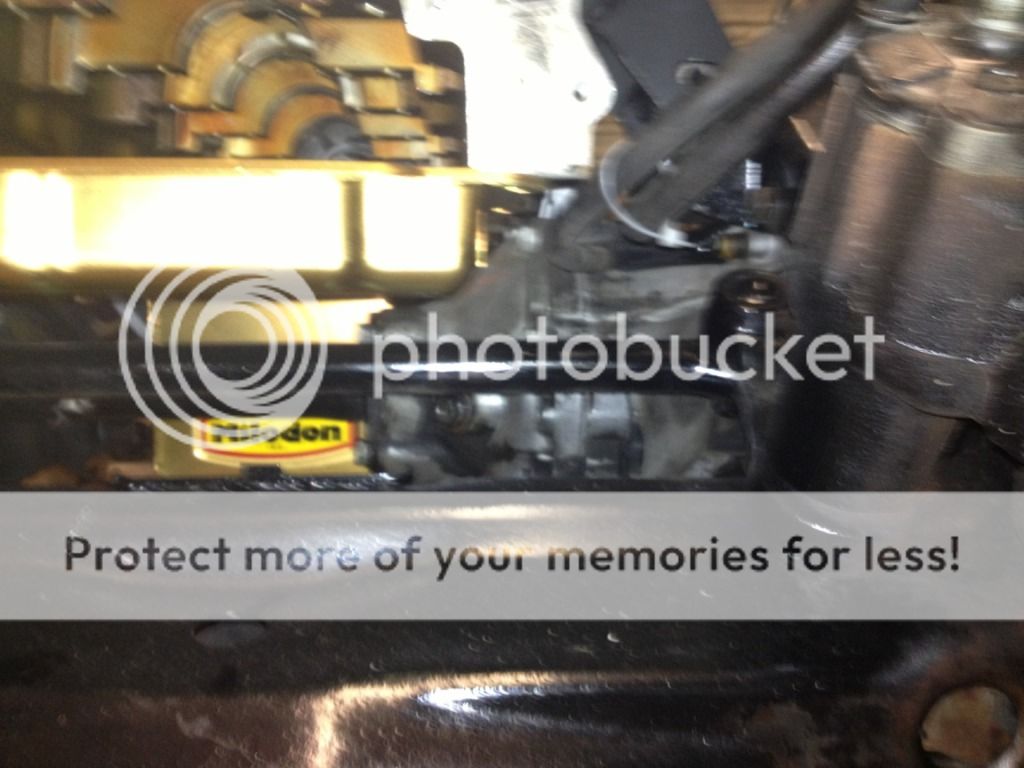

But, Im not at all happy with my milodon oil pan fittment... Mainly where the lines are exiting the pan for the remote filter. The front line, which is the outlet from the oil pump, is IMO dangerously close to the front diff, maybe 1/8" clearance,depending on how the hex is turned:
Im contemplating blocking off the front line on the pan, and instead catching it from the front oil gallery plug on the drivers side of the block. Earls sells and adapter to give a -6 connection. I noticed in one of Jared form CPs posts, he adapted down the -10 pan connections to -6. It just seems small when you look at the size of the gallerys in the block. Im thinking of running the -6 to the filter, and -8 out of the filter to the oil inlet on the rear fitting of the pan. Or should I just use all -6 line???

Hmm, I didnt realize the 4wd was offset to the pass side. I used a Bravada cross-member with a new energy suspension trans mount. I bought the poly 4wd mounts and headers from Current Performance. And the Milodon pan from Jegs... Its all supposed to work together, but when I initially bolted it all up,my passenger header would not fit at all due to hitting the shock tower. Then engine sat 1/2" over to the pass side and was not sitting parallel in the frame. I ended up cutting the tabs off of the engine plates and welding new ones on to center the engine as well as raise it up some, so the pan would not be touching the diff... This allowed the headers to fit too. I had to massage the pan some still. Also lowered the rear cross-member about 5/8" to get the transfer case to not thouch the body... I called CP and he told me he never tried any of those parts on a first gen...
