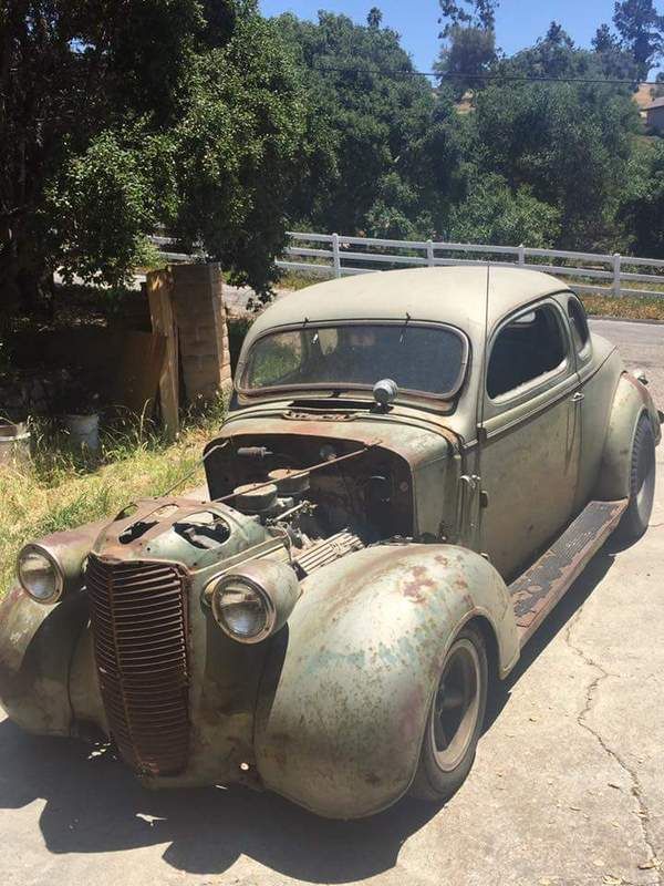

as for the bug body size .... heres an idea of what I was talking about with the late 30's actual body being pretty small
This build was part of my ultimate inspiration .... the actual main body (from windshield to where the back seats would be) is still actually Stock vw bug ;)

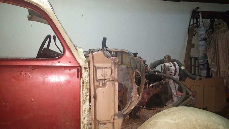

heres the front A pillar section all trimmed and tacked into it's new home ... the drivers door can be seen off to the side in the background with a grumpy hinge so it didn't get to be mounted for mock up
and heres shot showing how far set back the front section is from the stock firewall, also shows how much of a cowl it's going to have.
I won't be cutting the firewall to shape till I have the rear section/rockers in place and some bracing.

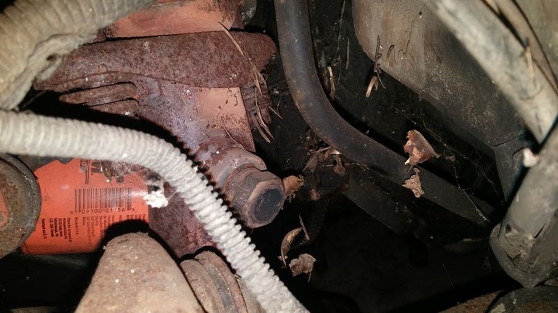

I noticed this (lessee how long Photobucket still works for me)
I think I found the 'banging' under the hood .... theres not even anything hanging off the harness... it's GONE .... side note I didn't see any obvious damage or loose in the flexplate/converter but I'll give it a proper examine once the engines out ... probably replace it anyways.
annnddddd there was coolant in the oil .... not alot... like half a liter... but it was there ...

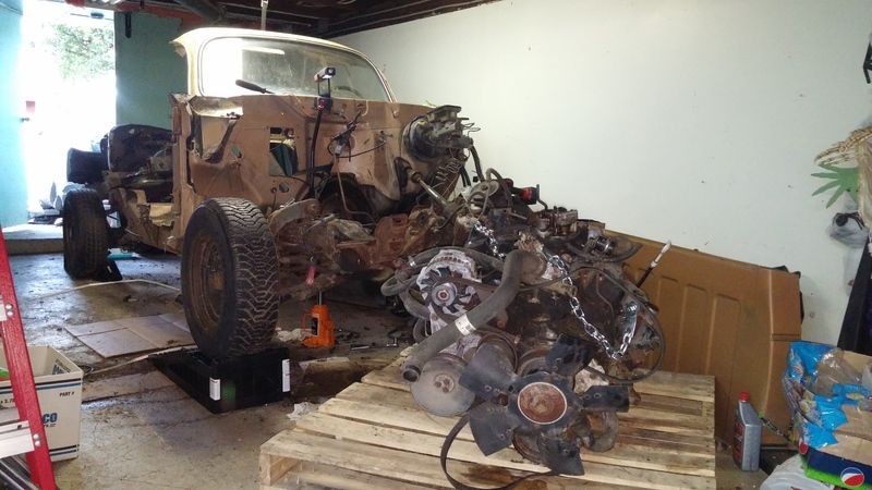

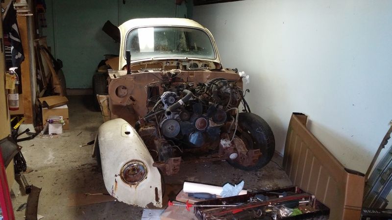

Okay! ... Engines finally out!
I have a friend that does a bunch of car scrapping and Mechanic work on the side is keeping his eyes out for a 3.4 shortblock for me ... if he or I find one quick enough .. the 3.4 will end up back in instead of the 2.8 .. instead of swapping out later.. meh.. either way
he even basically hinted he might be able to get his hands on a 5.3 LS with trans and harness for me for under $600 (NO idea the condition of ANY parts... it is a truck ment to be crushed ) ... while it's really tempting ... I don't think I'll bother with THIS build ...
the process of pulling this engine, I don't trust anything on this truck chassis anymore.... it's comming apart to be rebuilt/checked/or replaced ...
out of ALL of the bellhousing bolts... 1 .... ONE was tight... 1 was missing completely ... 1 was backed out enough to hit the firewall... the rest were litterally finger tight.. (IE my beat to crap hands, I undid them with just my fingers) ... add in the completely blown out 02 sensor ... etc etc ... yeah... things i was going to leave and take care of later... F*&^ it ... it all gets torn apart (this truck as running and daily driven after the 'engine swap' for a couple months.... sigh ) ...
I'm gonna completely miss my goal of having major fab done ..etc by school restarting in sept anyways ...
the fusebox is gonna need to be moved.... so the whole harness is getting moved inside the truck... I'll have to seperate out the bits that need to go to the engine/trans/front end
I do have to say... I had forgotten the struggle to pull and engine, without a vehicle lift... with out fancy air tools... and while caring NOT to cause an apocolyptic mess on the floor! ... haha ....
next is to get the trans drained and out .. cause I decided mid way through going to yank both at the same time... that I hadn't drained the trans yet... and it was going to make a massive mess under the chassis as soon as it tipped ....
