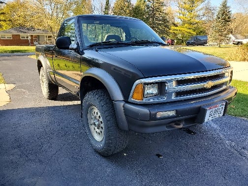

Hey guys. Just picked up a one owner 96 s10 for $700. Has a CEL on for EVAP system. Wondering if there is some free software I can use to connect my laptop to the OBDII connector to permanently disable some codes in the PCM? Any help is appreciated.
