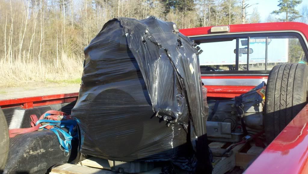

And here's what came in today :D
L33 with 29k miles and a 4L60e with 40k miles on it
Other part's on the way:

L33 is a great choice!!!
310 hp, aluminum and LIGHT.
Good luck on your swap!
