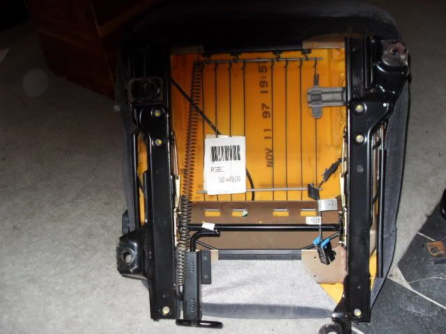

Underside of S-10 Bucket, stock seat track still on:
First thing you need to do is take the seat track off of the S10 seat. When taking it off, Simply feel in each corner between the seat track and foam padding for 4 nuts(13mm) and remove each bolt from all 4 corners, In the rear part there are two bolts (one in the corner and one in front) holding the seat track on.(bracket bolt pictured below) You will be removing a total of 6 (13mm) nuts.

Bottom of s10 seat (below)
S10 tracks (below)

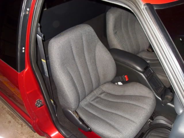

Here is a Cavi vs. S10 seat in the truck (Cavi seat on driver's side)
Here is a Pic of the final product, I removed the head rests for a better look.

Well it's been about 3 months and I still love these seats and have had no problems, being 6'5", they gave me more leg room, which i needed and are much more comfortable than the stock buckets. Even if you aren't abnormally tall like myself the seats shouldn't make you sit too low, i wouldn't worry. With the head rests taken off, it will sit just below the rear window i believe. And yes, the swap is the same for a 98+ blazer. Again if you have a 60/40 or buckets in a 94-97 s-series you will not need to drill the holes, should be a direct bolt on. 98+ you will have to drill new holes.
Here's a pic of my pass seat w/o head rests, i ditched them bc they werent in the best of shape.

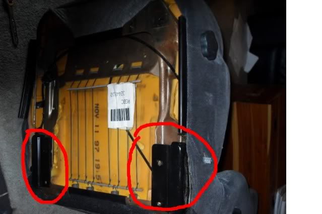

The L bracket is the rear mounting point for the seat track on the original s-10 buckets. There are 2 bolts that connect the seat track to the L-bracket on each side, if you feel in between the padding on the bottom of the seat and the seat track you will feel two bolts there, remove those and you will free the rear part of the seat from the L-bracket.
The L-brackets are circled in red (this is a pic after the track is taken off of the s-10 seat.) This view is of the bottom of the seat with the top of the pic being the fron of the seat and the bottom being the rear.
