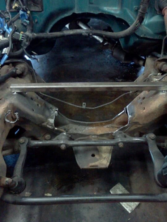

Made room for the Oil pan for dropping the motor an inch.
An inch sectioned out and welded back in.
Motor mounts cut apart to drop the motor an inch
And welded back together. I later learned that you can't drop a 2.2 and put a cavi intake on it, so live an learn. i have new motor mounts that just got delievered so i'm gonna put them in this weekend. and the motor will again be in it's stock location and can then install the cavi intake.
And the motor installed an inch lower incase anyone wanted to know what it looks like.

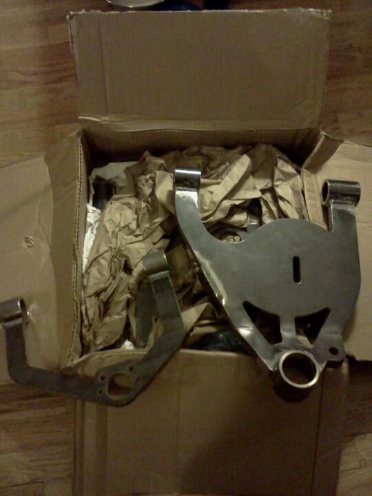

MMW made some SICK control arms. I bought the budget arms cause it only makes sense to spend a little time swapping over the cross shaft and installing the bushings myself to save like $300. FYI, the lowers are HEAVY AS F$CKING HELL.

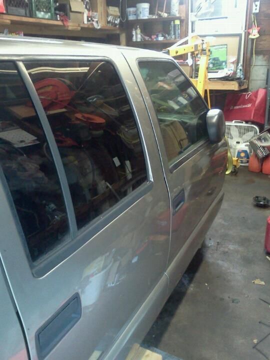

And this is the cab that's getting swapped in so it holds the whole family.
It's tucked away in the garage in case Sandy wanted to launch a random branch at it. Drove all the way to Pitt to pick this up(thank you Dave) and came with a complete interior......SCORE!!!!!!
