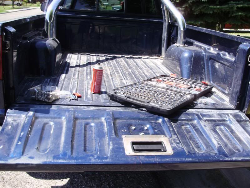

Finally getting my ass in gear and started on the tailgate.
Figures when I actually try and get something done someone else comes along to mess things up.

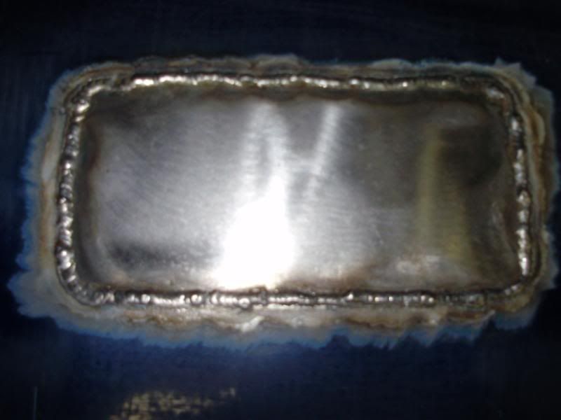

I paid a welding shop to weld in the filler plate and they warped it all up.
Didn't even try to tac weld, just went all the way around with a solid bead, no wonder it warped.
They said they are not liable for the damages.

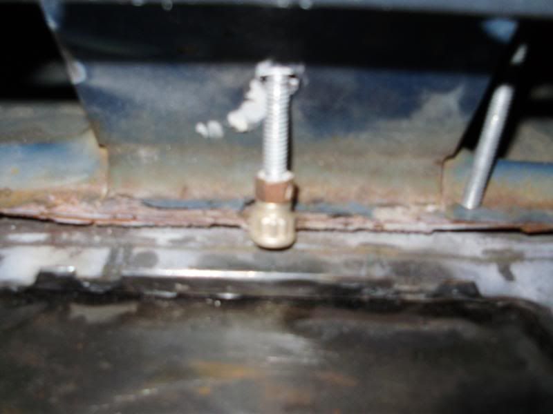

I drilled 1/4th holes and tightened 4'' long carraige bolts through the holes until they hit the internal bracing and there was a pop and the bottom half snapped back into shape. Lucky me. I'm going to cut the bolts down so they atleast sit 'flush.'

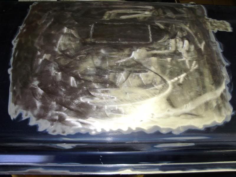

when you put the filler on the tailgate sand it with a long board so thta you get it straighter i warped mine a little bit when i narrowed it but i got it pretty damn good but it also took me a fair while to get it straight . the truck looks good keep it up needs a lttle lift and some bigger tires though
I decided the only lift I'd ever put on this truck is the solid front axle swap, I don't have the skill or money for that now, so I'm going to get 32'' tires in the mean time.
I really need new tires, my old 2wd truck had better tires than my ZR2.
what exactly is a long board? just a long sanding block? lol
I was going to try a standard sanding block, or I was thinking about getting a variable speed palm sander.
Either way I'll need to use light pressure and really long strokes to make sure i get a smooth tailgate. that's a long stretch of metal I'm not sure is straight or not. that's why I went really wide around the filler plate.
The first coat I'm going to keep sanding until I see mostly metal again and just little spots of paper thin body filler. Then see how straight it looks, but I'm guessing it'll need to be about the thickness of a quarter to look straight.
Body filler sticks fine to previously laid/cured body filler right?
When you sand, hold the board level and make an X pattern cross cutting with long strokes. A palm sander will never get that strait.
Filler will stick to filler, just make sure there is 36 grit scratches on all surfaces.
Do not try to just fit the dent with the filler. Go over the edges of the dent a lil bit. You want to bridge over the dent making the illusion that it is not there.
I have used a 1x3 piece of wood as long block. It worked fine.
yea i made my own long block and then bought the roll sand paper from canadian tire and use it and it worked awsome my board was about 3 feet long maybe

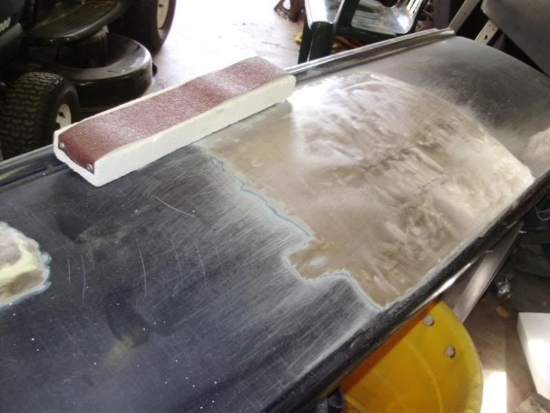

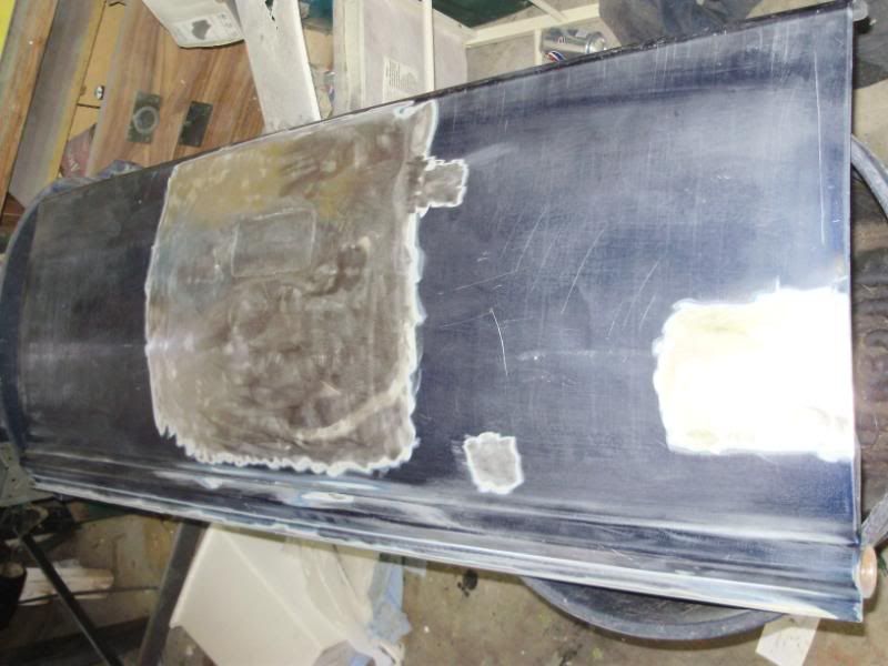

So took the tailgate back off and started using Evercoat's rage body filler.
Made a 'long board' thanks guys.
That's probably good enough, I don't want to grind holes through it... the warp damage is deeper anyway...
Here you can see how bad the warp damage is, compared to the first post not bad at all. Just lots of ripple under and above the handle.
I hate sanding
Looks like a monster shooting fireballs.
That is just the first layer, I need to go back with 36 grit to scuff up the body filler and spread another layer down. I don't recomend it, but since this tailgate is warped this bad it's going to need it to look straight, it'll probably be around 1/4'' deep when I'm done with it.

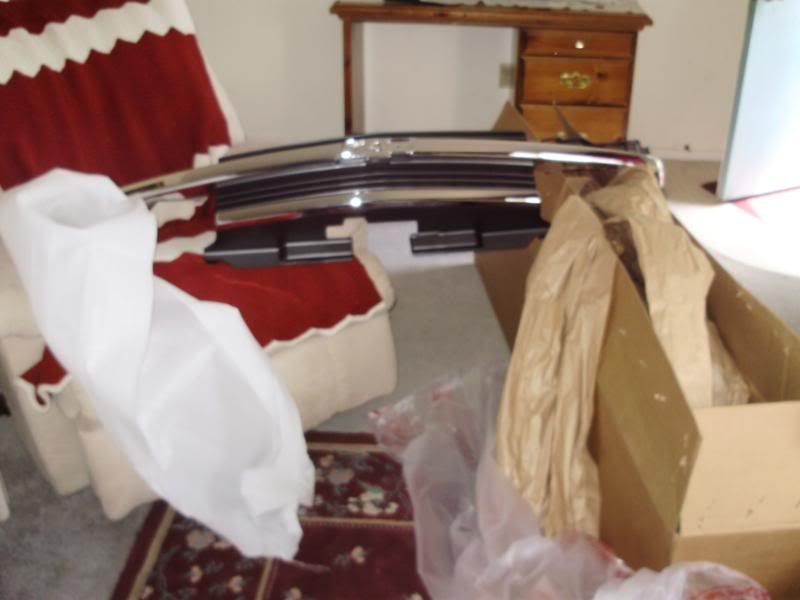

Got the LS Grille, turns out I'm still missing the bumper filler, but since I plan on changing bumpers soon I'm not going to worry about.

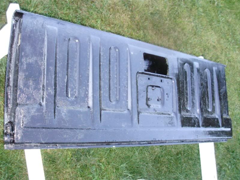

Then I got the tailgate ready for Chassis saver.
I'm surprised I was able to get those hinges off.
It was a pain getting all of this out.
The top was easy.
Next step was to take those 3 carriage bolts out and grind the last of the paint on the backside of the tailgate and those little tight spots along the top.
The other side of the tailgate is still holding it's shape even with those carriage bolts not holding the brace work. Lucky me. I Still don't have much faith in this tailgate.
6
Got the chassis saver on, I used "Jet black"

lol that was from a welding shop? those welds don't even look that great. was the guy that did it smoking crack?
Yup, for a time I considered buying a welder and trying it myself then thought. "Yeah right I'll **** it up if I tried." so I thought I was doing the smart thing taking it to a ''professional'' welding shop. It wasn't even a machine shop that did welding, it was ONLY a welding shop.
Next time I think I'll take any welding jobs to an Auto-body shop.
next time, try a body shop. just a suggestion.

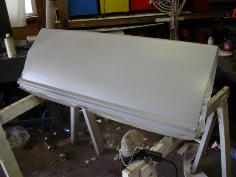

Did get it to primer in my parents messy garage.
Really surprised how straight it looks! It was a wavy tsunami in the pictures above
