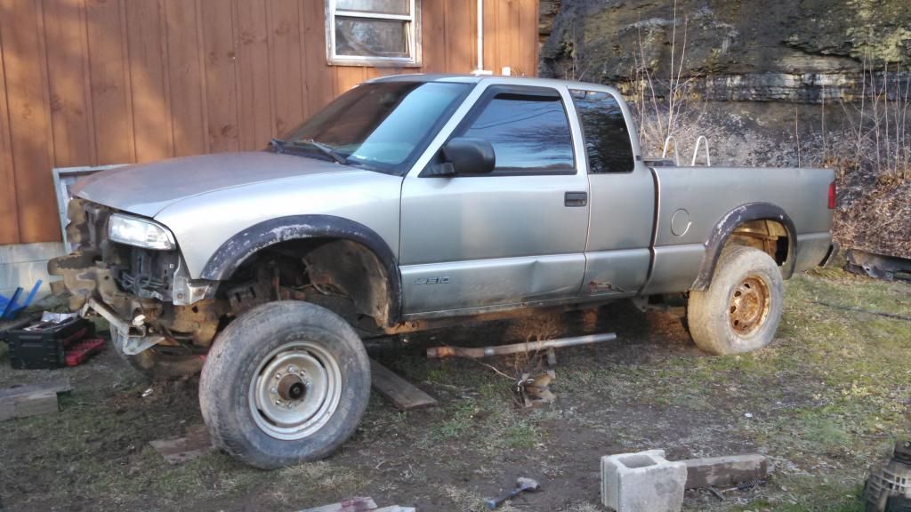

thats how she sits right now i've got the ifs out and next plan of action is to fix the frame
yeah its pretty bad but now that i've got the junk out of the way i can figure out a plan to fix it

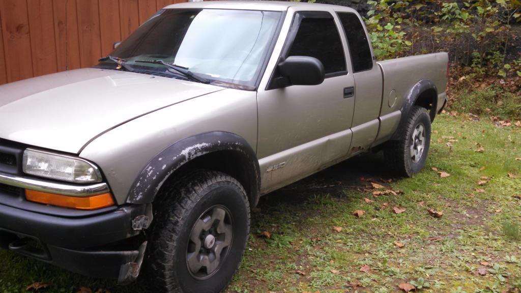

its ok ish its got buckets tho which i dont like. outside is actually pretty decent for this area their just isnt a hole lot of s-series in much better shape and its way better than the red one so i'm happy

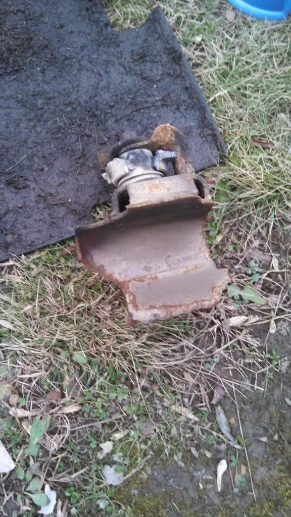

i think i'm gonna get a piece of c-channel or similar and shove inside the hole weld that solid then take the ripped off part of the lower control arm and weld it back where it goes and of course weld up the cracks and such

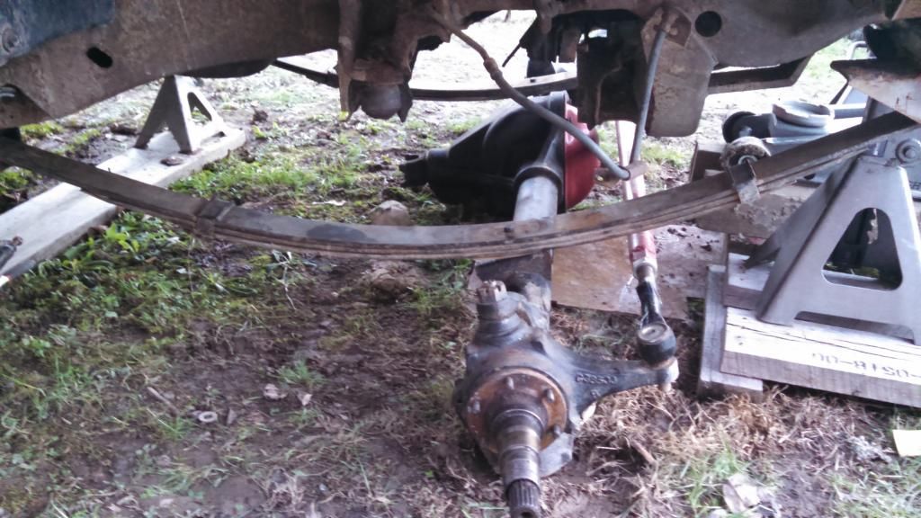

that thing was a bear to drag under there by myself i dont remember it being that tough last time lol. probably didnt help that it just wanted to sink into the soft ground.
i havent tackled the frame repair yet but i have some ideas just gotta get some metal
I dragged the d44 under the z, after that experience I put the wheels on the axle and rolled it under lol.
if i had a shop crane(cherry picker what ever you choose to call it) i would have done it that way, but with just floor jacks its pretty challenging to get it jacked up high enough to do that. i'm a wuss when it comes to jacking a vechile up now too. every since ol' red fell i get scared of a repeat lol
I know lol, I had some tall logs that I set the truck on to get the axle under it.

the bad spot is in the front, lower control arm mount ripped clean off. and there isnt a d60 that will match waggy width. altho you are correct the 14 bolt is way over kill for my use but i already have it so its getting used

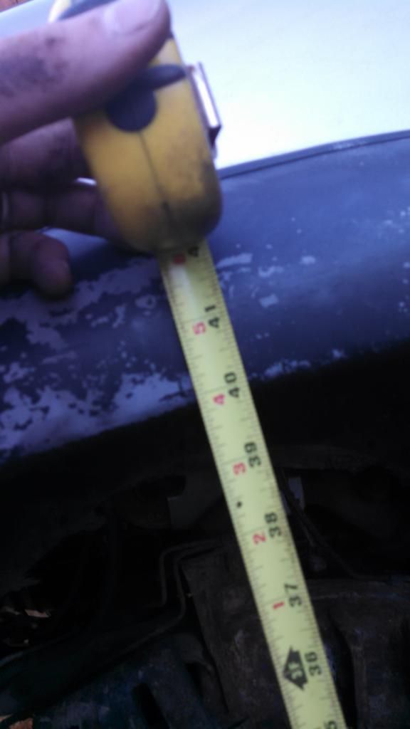

throwed some rollers on it today it seems pretty low to be soa. the rear is still sitting stock
ground to fender in the front with bald half flat 265's
I never measured ground to fender, but it is 13'' from the top of the tire to fender, and 28.5'' from ground to bottom of the door.
