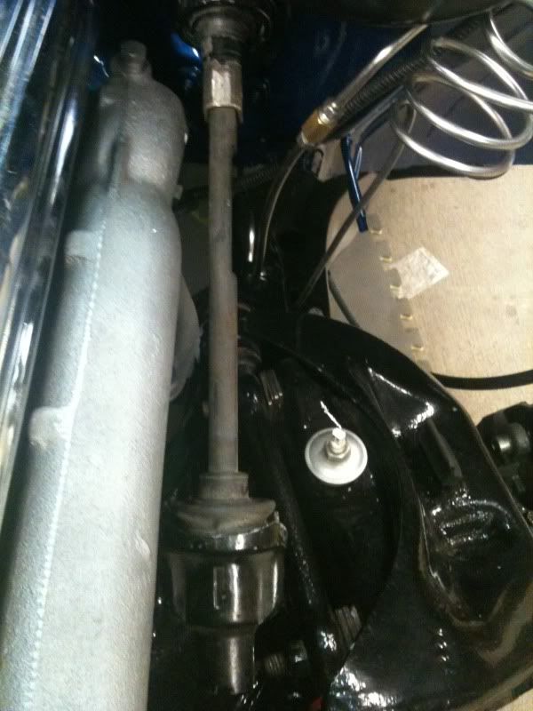

I need some opinions on what to do with my steering shaft. I'm using camaro manifolds, and I bought a ford f150 u joint, but it's hitting the maifold. I'm not sure how much smaller the flaming river u joint is in diameter, but I doubt it's small enough. Any solutions?
Here's a pic with the dd shaft in it.

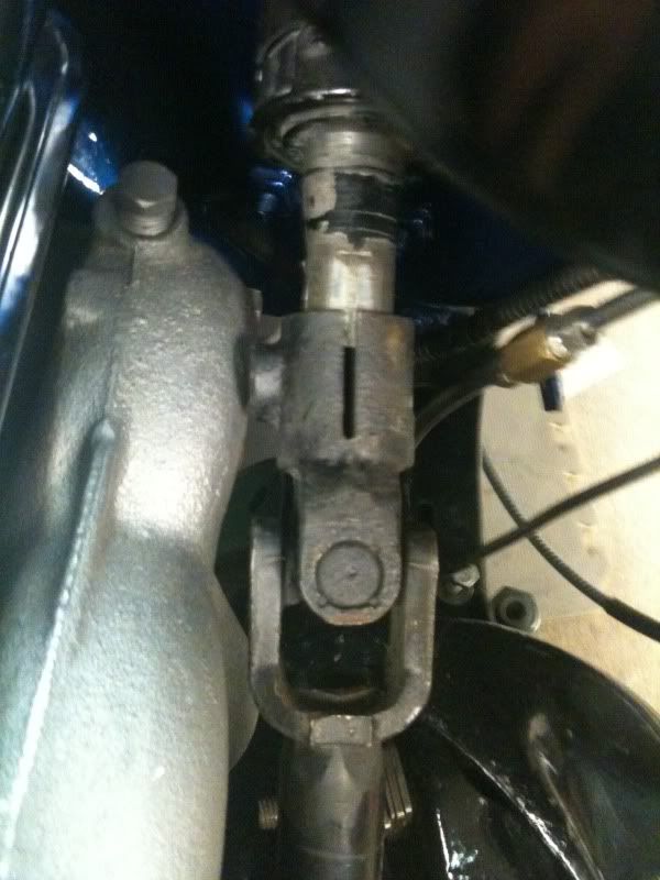

I just slid the u joint on there to get the idea, when it's on all the way it hits.
Well I though about putting the u joint between the firewall and steering box, but won't I need some sort of carrier bearing to support it?

If I put a double u joint at the steering box it would be a strait shot to the column. I tried loosening the bolts holding the column down, but it didn't budge on the firewall.

How you considered elongating the holes in the firewall so you can move it away from the manifold?
X2^ This is the way to do it. It actually straightens the steering wheel in a 1st gen, IDK about a 2nd gen tho.

I contacted Speedway Motors about my issue and sent them a drawing with all the measurements and clearences. Im going to do a double U joint at the box going to a 1" dd and a 3/4" dd going into that to allow for crush, and the other end of the 3/4 dd into my column. They recomend I have some sort of support on the shaft, so Ill use a heim support.
