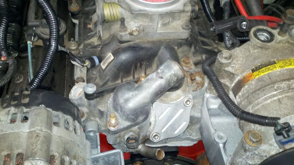

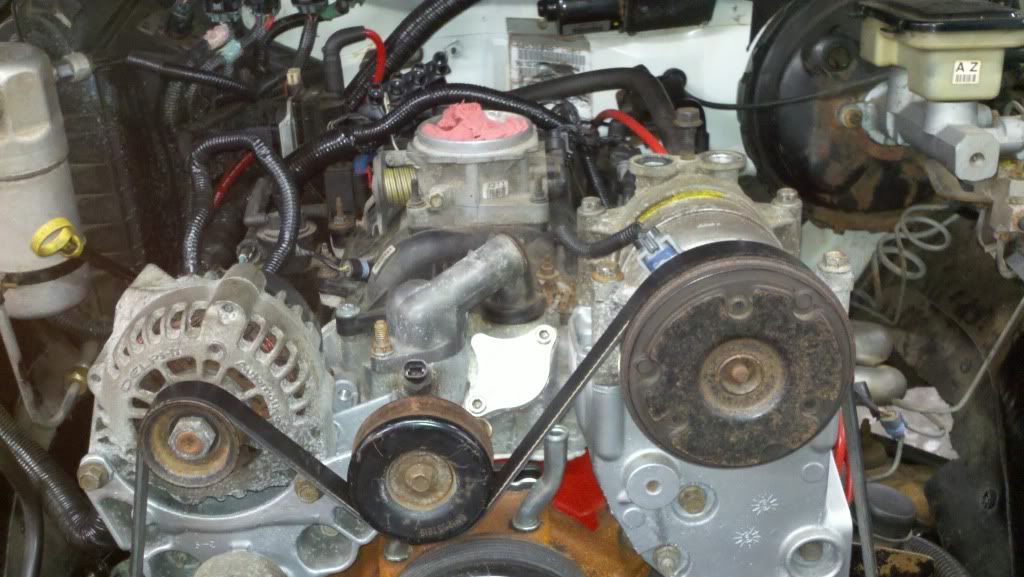

I bought the S10 with intensions of doing V8 swap. S10 did not come with any drivetrain. I bought drivetrain out of 96 Tahoe with 100K. Reasealed the motor with all new gaskets and water pump. Trans got overhauled with all new parts. Here are some pics. This is my 1st swap of this kind. If any advice, please let me know.

Looking nice. Im looking forward to a vortec 5.7 swap into my current blaze at some point.
I did a square body 5.7 swap & your pics look identical. Looks good so far.
Here are my tips. Turnbuckle style torque strap for the drivers side, keeps the header from coming up & hitting the steering shaft.
BFH the firewall behind the distributor & by the header flanges. Might be different vs the old style but it looks pretty tight in your picture.
use a mini high torque starter or try the starter from a 4.3. you will never get the 350 starter out if it goes bad once its all together with exhaust on.
Get some really fat tires because your going to need them! And if you see a cop you might as well floor it, because he will never catch you.
EDIT: Thinking back, I know i ended up using two different transmissions a TH350 & a TH400... I had to cut the side ears off the bell housing on one of them.. but i cant remember why or which one this many years later. sorry.
169 Posts
Ya engine is tight fit in there. There is basically no room for anything. I'm getting different I shaft. For now I'm gonna stick with stock wheels but I do have 20's laying around. I wanted to put 8.8 rear in the future and juice it. Its going to be used for house chores. My DD is 08 TL TYPE S with few mods.
