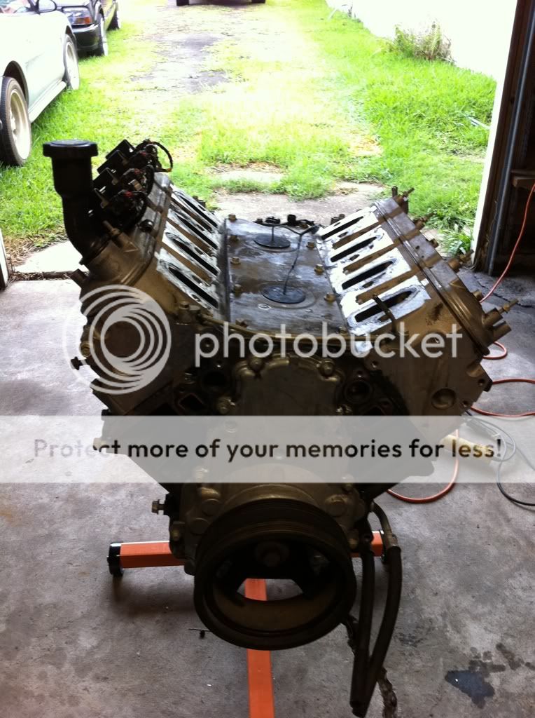

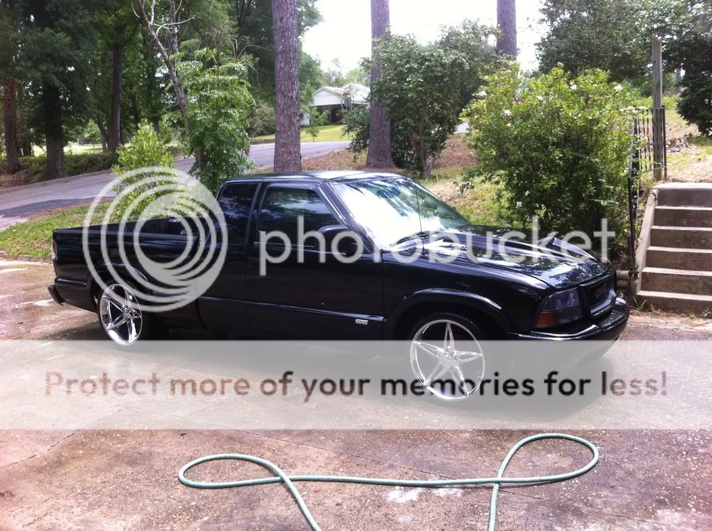

Okay I've been planning on doing this for awhile now. But I have been so busy with work. Work has slowed down, do I figured it's a good time to upgrade. Truck currently has a 4.8, 4l60e, 8.8 explorer rear end, and 3.73 gears. Whoever did the swap could have done a cleaner job. So I plan on doing everything right and clean with the 6.0
Here's the truck

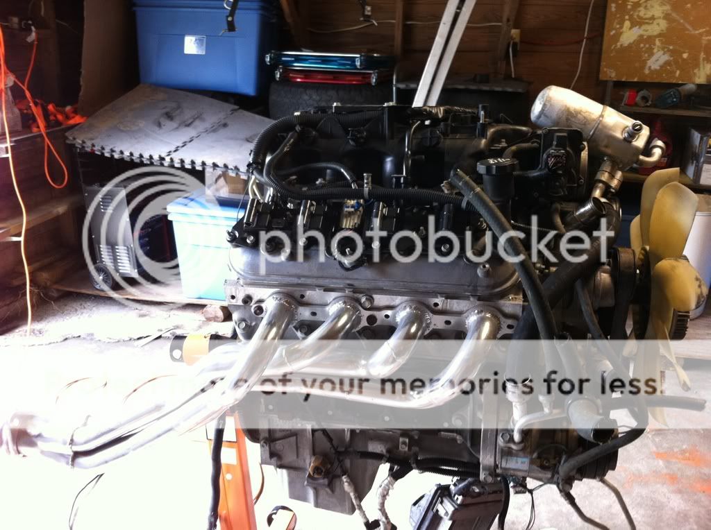

The lq9 6.0 with cpw headers

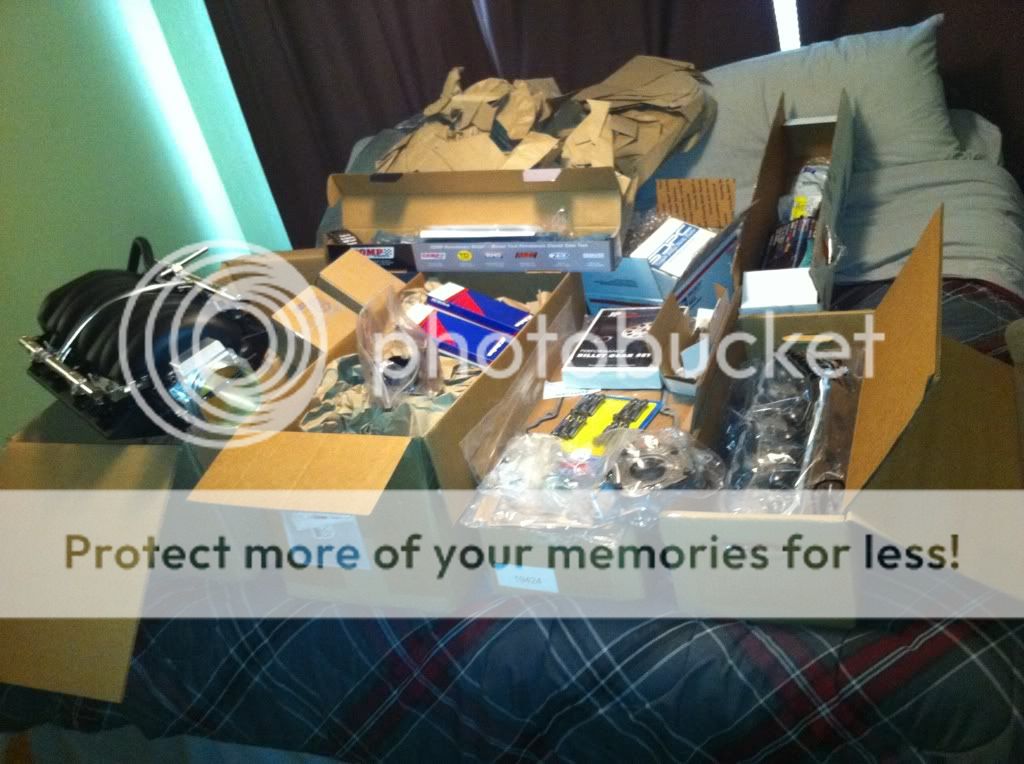

Just got a few parts today
Ls7 440
838 Posts
So far I have
06 6.0 lq9 48k miles
Tsp cnc ls3/l92 with 650 lift springs
Tsp cam 229/236 .624/.615 112 lsa
Tsp ls6 ported oil pump
Arp rod bolts
Double roller timing chain
Ls7 lifters
Chromemoly pushrods
L92 rocker stands and offset intake rocker arms
Ls3 intake, 42 pound injectors, and fuel rail
92 mm dbc throttle body
Scoggin dickey billet throttle cable bracket
Current performance long tubes

Yeah, it had the covers on it when I bought it. So I just left em.

What does it look like to you? It's a 6.0 flat top piston out of a escalade.
Can barely see the 6.0L stamped on the block. I can take a better pic in the morning when I get off work.

That's good to know on the cam sensor...

looks like an 03 or 04 lq9. All the 05+ that I've ever seen have the cam sensor on the front cover.
Should be a nice change regardless
Thought I should clear the air on this one. The front cover cam sensor is on the GEN 4 engine meaning that in 06 the LQ9/4 were still the GEN 3 and the LS2 was a GEN 4. all LQ9/4s prior to mid 07 (2007 classic GMT trucks) came with the GEN 3 engines.
