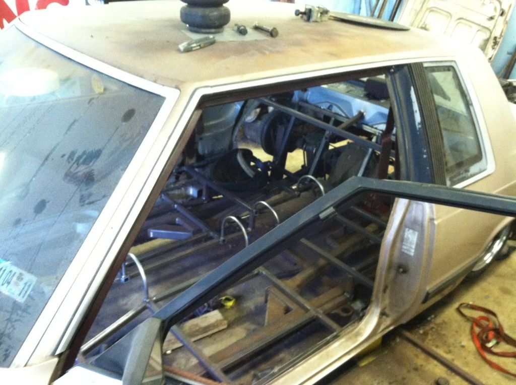

hello everyone. a close friend of mine bought me a car for christmas, the guy that originally owned it, owns a motor shop and rebuilt the stock motor to make it into a sleeper. well he told me the motor should handle around 22psi of boost...but im not out for speed, so i pulled the motor and gave it to a buddy to use, but he scraped it. well i had an extra s10 rolling chassis, alot of 2x3,1x1 and sheetmetal to spare. i also have an 87 sbc with low mileage...so lets put them together. i built an underslung chassis,(at that point), i am going to notch it since im forced to use such a small wheel. well, im using 15x7 hammers temporarily,and im goin for a rat-rod stlye with this car...it used to be FWD, now its RWD, bagged and bodied...lol so ill post some pics. hopefully you guys like it, cause ive had 3 of these cars and ALWAYS wanted to do this, now i have the chance and im gonna make it happen. the fuel cell is a stainless electrical panel from work that i cut up to make a cell, i tig'd up 2 stainless air tanks, this car will get all stainless lines, im running a 2 link with front and back air suspension. probably gonna get a rear disc conversion if i dont find a blazer rear...anyways...heres a few pics...

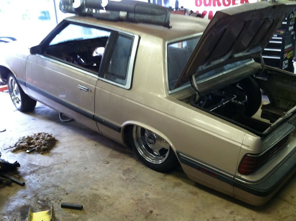

and heres the car the sits over the frame:
the motor in the car before i lowered motor:
all that fun stuff plus its getting a 49' ford shoebox dash, i have a dakota digital gauge for the dash already, im running a lokar nostalgia shifter, sbc 350 with a 700r4, the driveshaft is gonna be extremely short...lol
oh, and yes, it is a plymouth reliant. yup, 2 door k car. :haha:

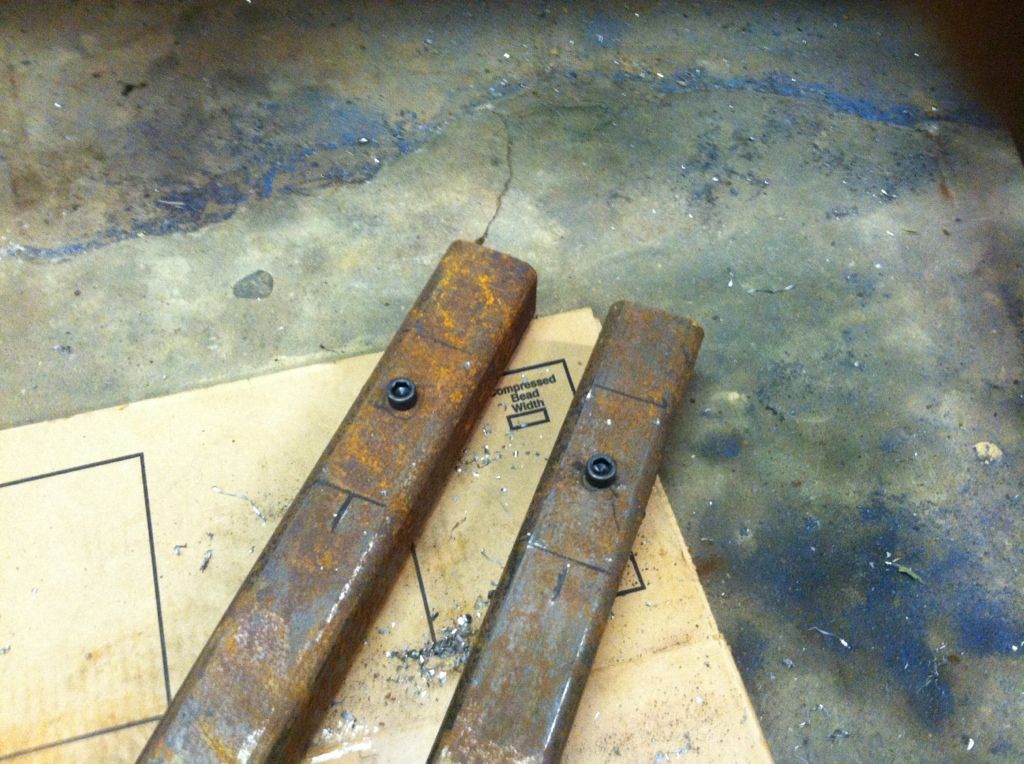

I "pinned" the link bars, I drilled and tapped 3/8"-16 holes and put Allen head bolts in the bars that was slightly smaller than the hole in the lowering block.
I just had a temporary block in that I welded up until I could find what I needed.
