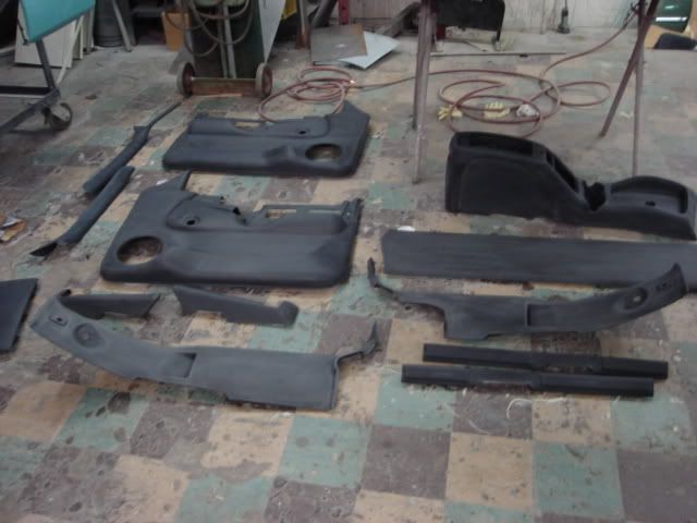

I will start with the hard plastic pieces such as the door panels, and center counsel.
These are a little bit easier to smooth than the softer panels such as the dash..
The first step was to sand all the texture off of the panels, I must add that brian took the iniative to do most of this part himself, and i must add that he did a great job. Thanks brian!
Those panels we're sanded with course sandpaper, not sure on what grit brian used but i think it was 80grit, I might be wrong, maybe brian will chime in on this one.
I do know that before priming all of the texture was removed and they we're final sanded to 180 grit.
Here is a picture of all the panels prior to primer.

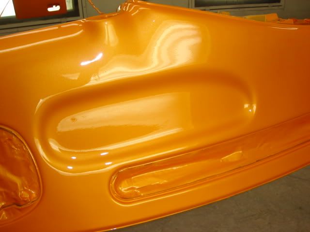

Now that the dash and other panels that we're soft are sanded for final paint, the parts we're all moved into the booth for the pro-spray lamborghini orange base coat and spi universal clear.
Step #8
Wet-sand and buffed as described above!!

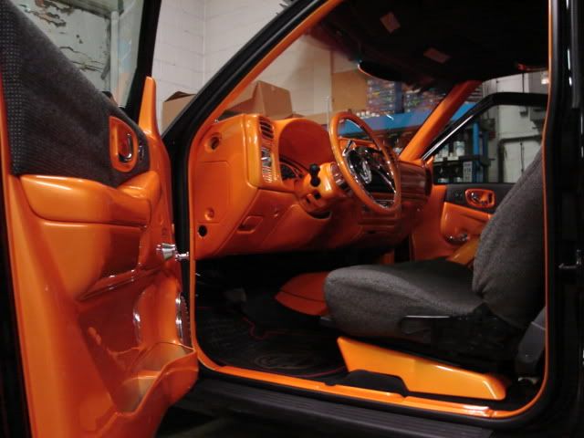

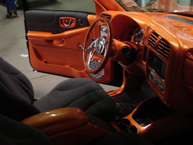

The next step was the assembly, which was performed by brian, he got this thing back together in no time..
Here's a few pics

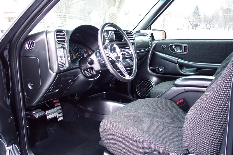

I know that brian has sense changed the color to a charcoal.. maybe he can post up some updated pics.. It looks great in the new color also.

heres a picture of the new color and when i saw it at ITB 2006 you couldnt see any texture and i'm sure you cant now either being as he just redid it a few months ago.
