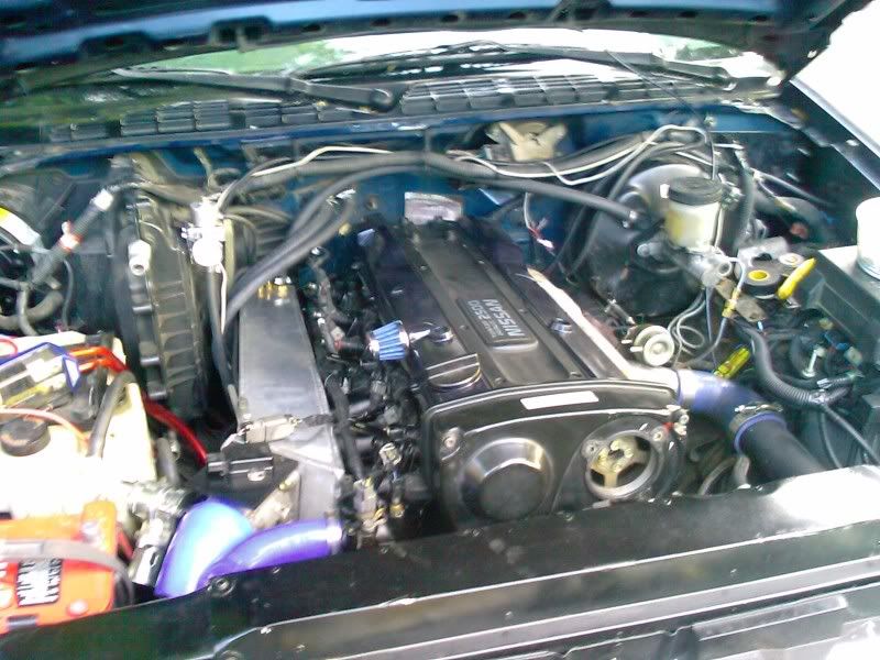

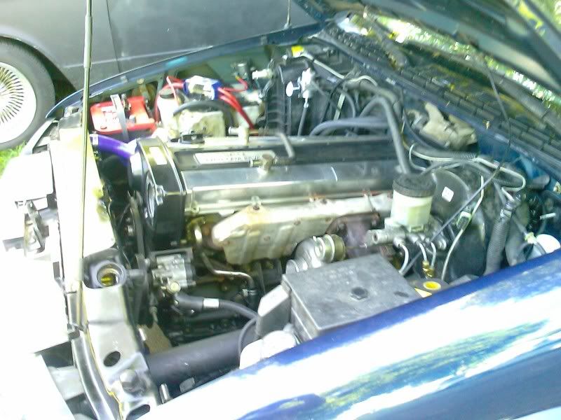

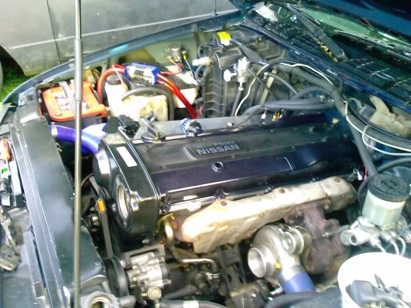

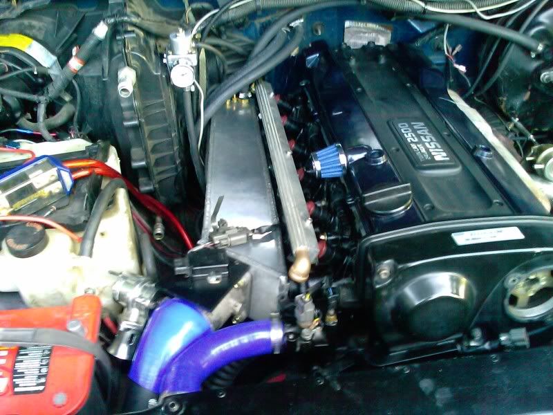

i started posting in my other thread but i figured a new one would be better, it is now an rb25 since i broke the rb20. i got the parts to fix the rb20 but i got a good deal on an rb25 which in all ways is a better motor. So i dropped the rb25det in the truck here are some new pics, i do need some input tho should i go with the polished covers or the painted covers? The covers are different as you can see in the pics i like both so im lookin for other opinions.
these are the polished rb20 covers
the rb25 covers painted the color of the truck
and here is the fuel rail installed, shes almost ready to start

go woth the color matched ones. The Polished ones are cool but don't flow too well in the engine bay i think.

pretty much the same, i dont have to change the wiring really at all and with the new engine the intercooler piping is shorter. All the engines are basically the same when it comes to the rb engines, water pumps, oil pumps, trannies and some others swap between the different rb engines. I do like how clean the painted ones are in how the plumbing is ran on them vs the rb20 ones(polished ones)

ok it runs guys :D had to sort out a few problems with putting the newer r34 skyline coils on it but she purrs nice now. Im gonna run the haltech again and i just had it running on the rb20 ecu to see how it would work without ruining the haltech. i'll try to get a vid of her running when i get the haltech hooked up and the ic pipes buttoned up. I can feel the air from the turbo pushing out the hoses now at just idle!!! it should spool the turbo faster making more power at lower rpm.
