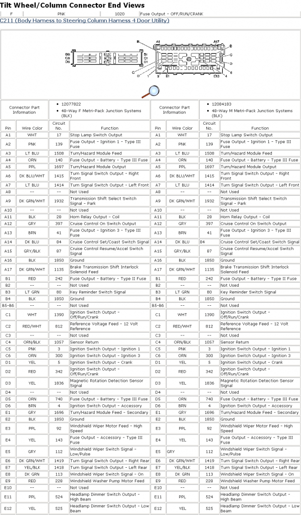

Here is the shifter plug diagram and the location of the column shift switch.

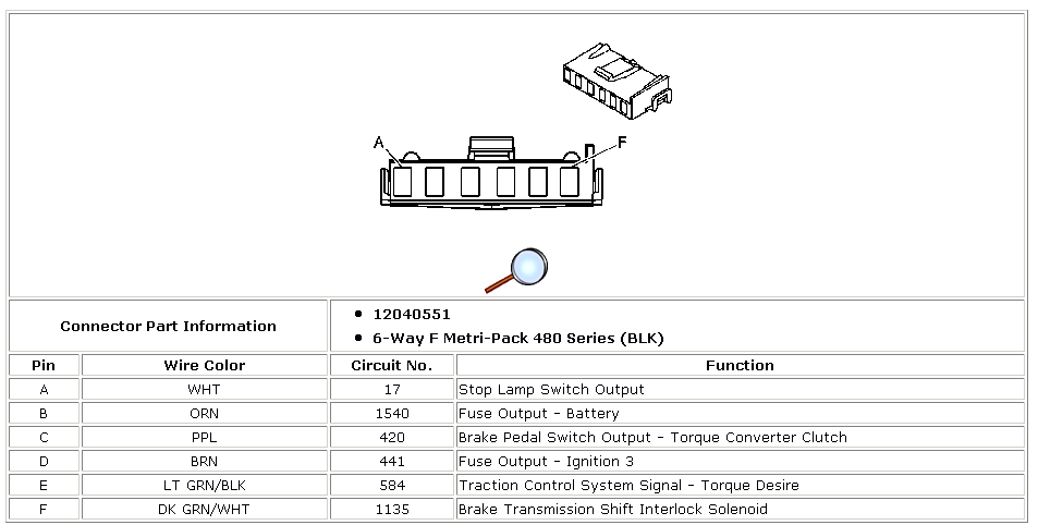

How did you get this to work? The wires on the column solenoid (dark green/white - black) supply power when the brake pedal is NOT applied, and remove power when the brake IS applied. The solenoid on the floor shifter needs to work in the opposite fashion. Did you tap into something else besides those 2 wires going to the column solenoid? The connector on the floor shifter has 5 pins. Do some of those need to be connected to something?
I'd rather not resort to tapping into the brake light switch as this would activate the solenoid every time the brake is pressed, wearing out the solenoid, whereas the wiring on the column only works when the shifter is in park.

I spliced every wire where it woukd have been if the jimmy came with a floor shifter, one at the brake switch, a few at the column and some over on the passenger side. if yu want i can track down all of the splices.
I got it working. The column solenoid was a 2 wire setup whereas the console solenoid requires 3 wires to work.
Instead of using the green/black on the column, I tapped into the one by the brake, and also tapped the green/white. So pins A,B and E on the pic you provided is what was required.
This would have been easier if I had a harness. Thanks for posting the pic.:tup: I was zip tied before and always wanted to get it working properly.
