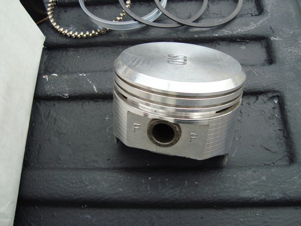

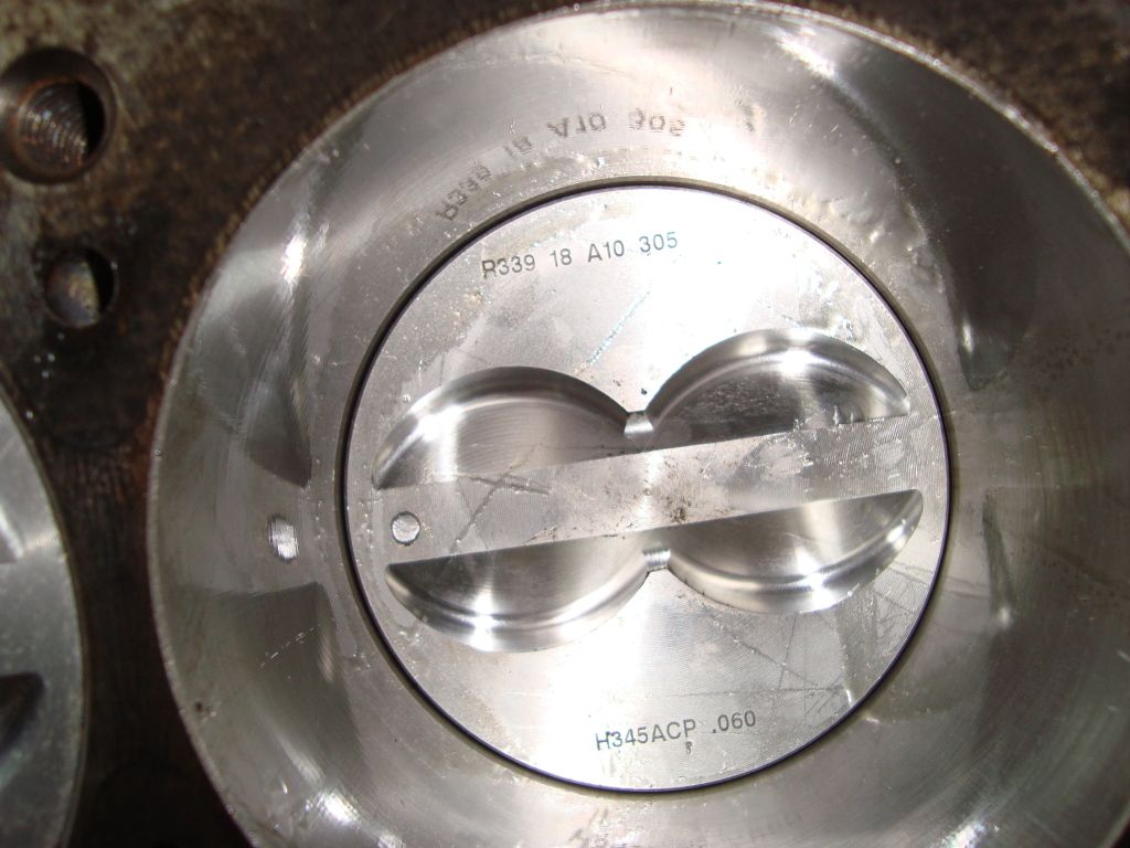

5. Chevy 350 flat top pistons. They have the same compression height as the stock dish 2.5 piston (pin to piston crown distance) and the same size piston pin too. You can buy a hypereutectic 350 piston for $16!!! Compression will increase from 8.5 to a little over 9:1.

Some pics of parts:
Hypereutectic 350 pistons and fresh Clevite bearings:

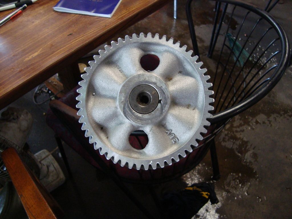

Aluminum cam gear:

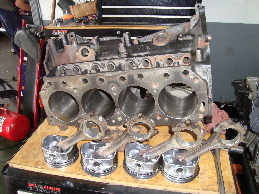

Fresh flat top 350 pistons installed in the 2.5 block

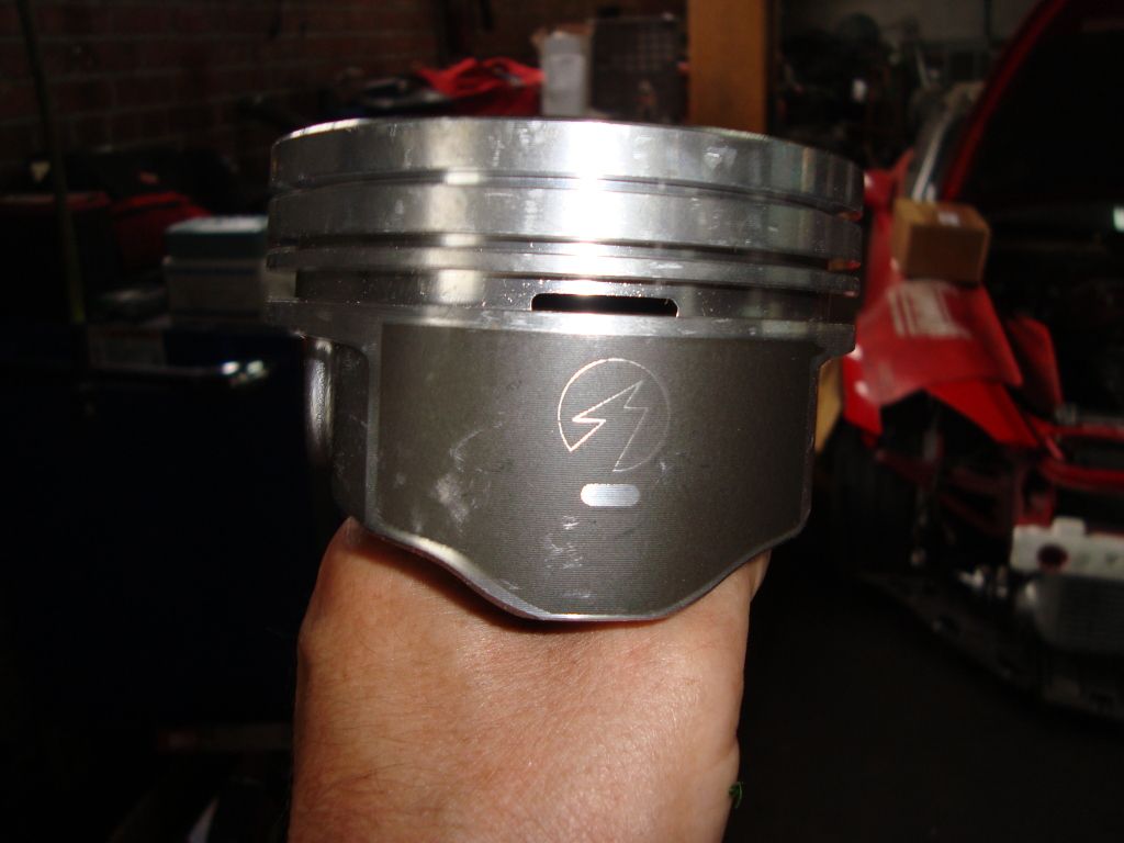

Another pic of the 350 piston:

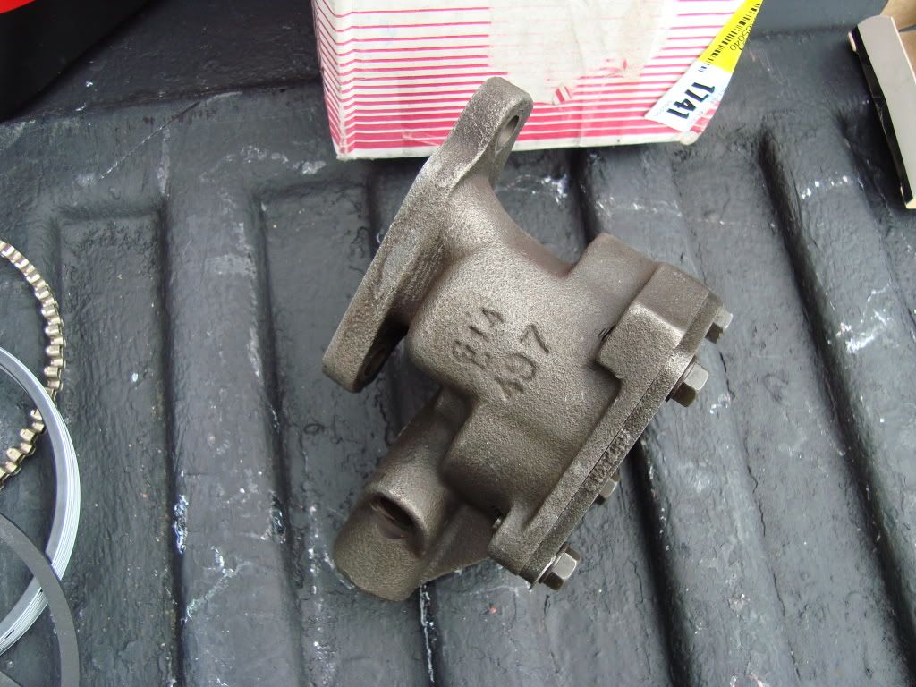

Fresh high volume oil pump:
Here's a pic of a Pontiac 301 V8 piston. They also fit the 2.5. The 350 pistons are a better choice.

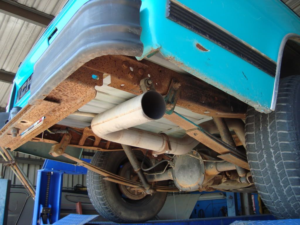

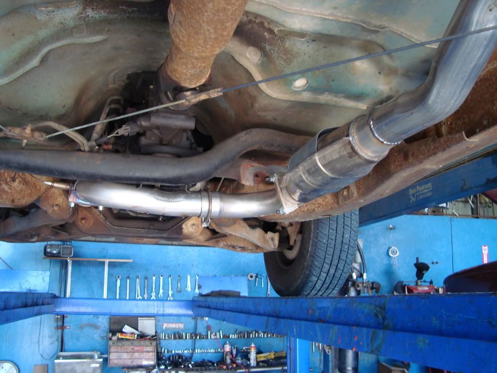

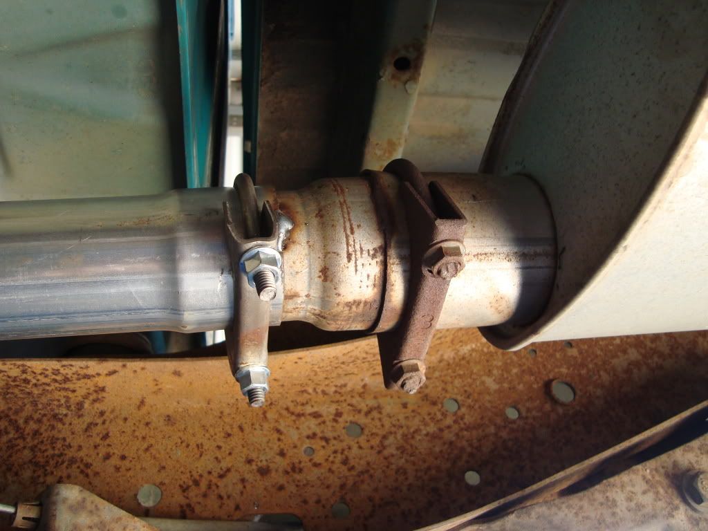

Here's the exhaust that will help the engine really breathe...
I installed a very expensive Clifford research header... a quick pic of it:
I had a muff shop bend up a cross over head pipe that is 2 1/2", it empties into a 2 1/2" high flow cat.
This is another mod I had to do, you won't need to do this since the O2 sensor is built into the factory header:
From the cat, the pipe is still 2 1/2" and goes to a 3" muff.
Here is the transition:
And lastly, to a 3" taipipe...
The entire system fits exactly like a factory GM exhaust. It hangs by the same brackets/hangers and looks totally stock.. . It's available from Summit, the link is above in the first post. This does not sound anything like Rice, it has a much deeper sound and doesn't really resonate in the cab.
