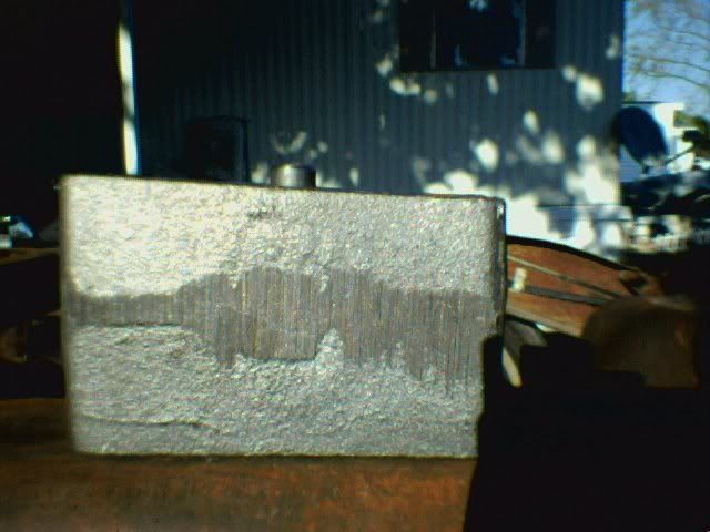

I already told you,... Taperd/Angled blocks are ment for EX Cabs,... not Single Cabs. thats why you couldnt find anything about using em on your application. You need NON-tapered blocks.

i know that but the taper on these is very slight, i had been looking at them for like 10 minutes before i even noticed they had it lol
like i said when i ordered i told them what i had and this is what they sent
then they screwed up and should get you the right parts. that taper would screw up your pinion angle and will cuase vibrations later.

return that shit and tell them to send you 3" blocks no taper/angle.

devilman13xx said:
thats what i ordered,only through summit, what should i do?
think i could go grab some 3" ones from like autozone then just return my angled ones and say they were wrong or should i try selling or trading the angled one?
thanx for the help
do yourself a favor and dont buy the ones from AZ. I've hear horror stories. Go to Summitracing.com and order you some Belltech 3" NON-tapered blocks and sell the ones you have,... or return em,.. up to you.

youll be fine man...the angled blocks are to help out the pinion angle on an ext. cab but mine have been great for the last freakin two years and i aint got no god dang vibration...youre straight...go ahead and do it unless you just wanna go spend another $20 on some more blocks...:rolleyes: its up to you

have fun replacing your u-joint.:rolleyes:

What devilman failed to mention is he will be removing the 2nd leaf from his pack,.. so the tapered blocks will correct the pinion angle once he does that. so its all good.
True dat.
