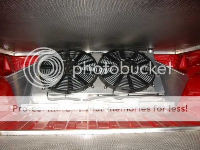

im building a turbo ls2 s10 and it may be necessary for me to relocate the radiator into the bed, i was wondering if anyone has done this and if you had pics it would be great.
this is a pic of the lingenfelter sonoma which has a radiator in the bed

I looked into this when i first started my build but decided against it. Also the tonneau cover wasn't a problem in the lingenfelter sonoma because they cut out a section of the floor in the bed and put wire mesh in there to help remove the hot air from inside the bed.

As long as you have a "great" set of fans and a consistent power supply, a bed mounted radiator won't be a problem. The Lingenfelter truck is a good model. The bed was cut out for air intake.
I'd also use an electric booster pump on your water circuit.
