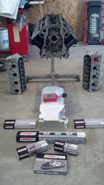

I've started to get all the parts together for my carbed LSx 5.3 build. Ordered a Comp 54-457-11 cam, springs, lifters, and pushrods. MSD 6ls controller, Holley retrolx oil pan, racing innovations stainless headers and stock rebuild kit. Still need to order the intake and mounts but I figured I can get those last. I just installed the Comp rocker trunnel bearing kit today and soaked the lifters in oil.
Figured I would start posting some pics and update as I go.
I powder coated the valve covers, valley cover and front cover. Going to run the camaro water pump and power steering pump and make a bracket to put the alt on the pass head.
