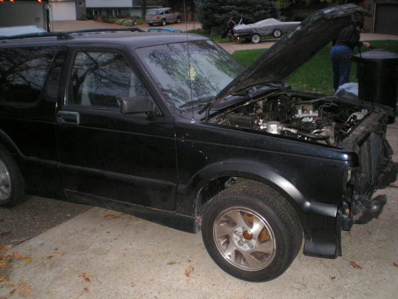

Here is a picture of the truck it is a 92 typhoon black/black.

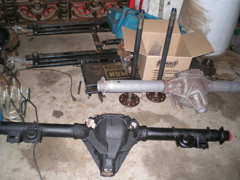

Here are some picture of the rear first is the 12 bolt housing with an 8.8 in the back ground:rolleyes:.

Why are ya guys using a 12b? Just curious..

We are using the 12 bolt rear end for the same reason as the halfton front differential, strength. The 12 bolt is being built with 33 spline axles(stock is 30 spline) a yukon duregrip center section. We will be running 3.73 gear ration with a 27 inch overall diameter tire.
Also the 12 bolt has the upper mounts already there for the triangular four link:cool:.
