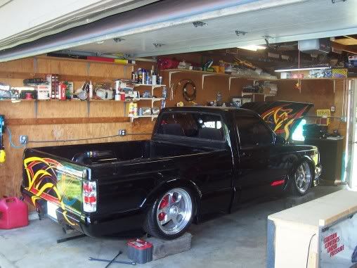

As the title states, this thread is going to follow the progress of JimHrabe's Syclone which as far as research has found, is the ONLY bagged Syclone. Not only is it the ONLY bagged Syclone, but it retains the factory AWD which propels the truck to a 12.9 second 1/4 thanks to the Turbo 4.3 V6. Yes, keeping the AWD meant keeping the 4x4 frame and suspension, and YES Jim has cut everything enough to lay the front crossmember on the ground with the axles and CVs still in tact up front. The truck has been bagged for quite a while now but just recently has Jim undertaken the task of laying it flat out. He's asked me to help him with a few things on it and gave me permission to start a thread to hopefully share with you all the truly badass, one of a kind truck that this is. On with the pics!

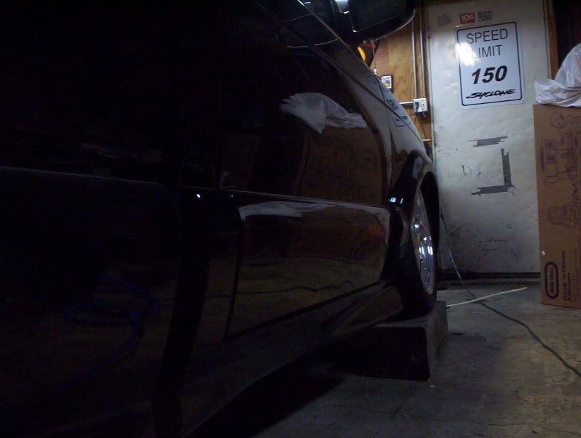

When I first met Jim in person last week the truck was in the garage with all the work done to lay the front flat out. The bed was off and Jim had gotten all the holes drilled and bolts in for the 1st gen ART Roadgrater that he had gotten for the truck. Since I started helping him we got the notches and gastank crossmember all the way in, bolted up the link bars and a 2wd axle (the truck had a 4x4 axle that was 2" wider per side), and cut out the stock tubs and center of the bed (it pained me to cut up a one owner Sy with only 40,000 original miles). Then we set the bed on for some measurements and fitment checks:
Did I mention that the 4x4 suspension has as much if not more negative camber than a Ranger when layed out?:

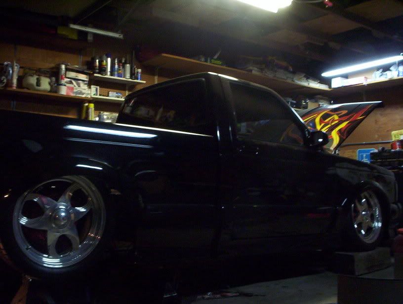

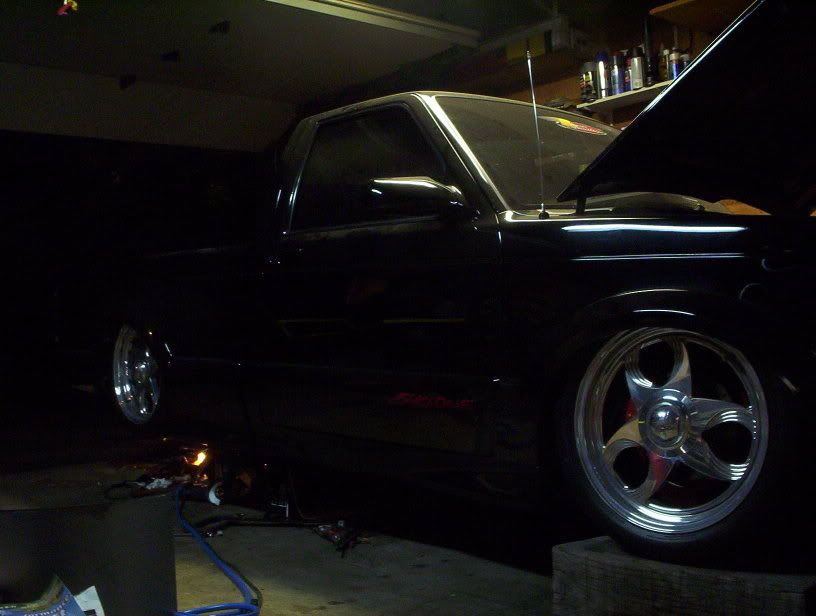

and a few more to show the lowness factor:

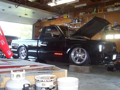

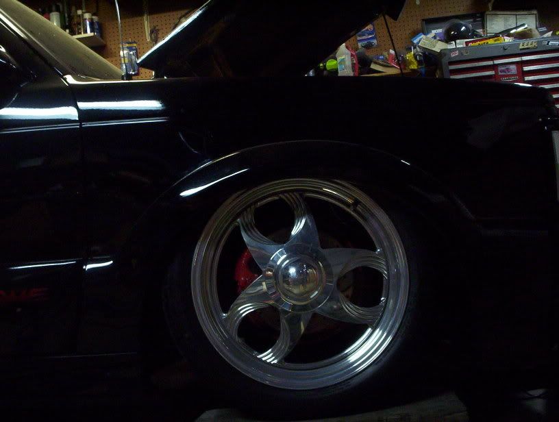

and then here's a few from what he had done with the front before I started helping him:
From as much as I know, the wheels are Billet Specialties and are 18x8s up front with 245/40-18s and 18x8.5s out back with 265/35-18s. They are a 4x4 offset up front and a 4x4 offset minus 1/2" out back. With the 2wd axle in now he'll need to run a 1" spacer to give these rims a proper offset. I'm sure Jim will post up in here to answer any other questions you guys may have or to throw up more info on the truck and maybe even correct some of the stuff I put up (hopefully I got it all right though lol).
