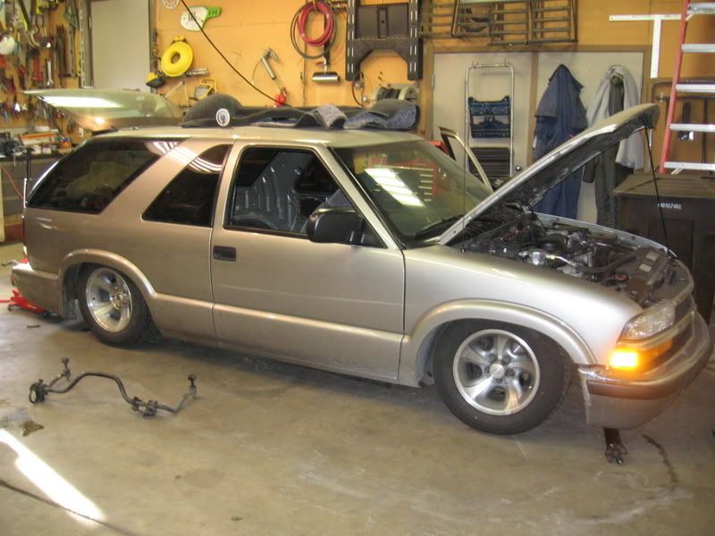

Stock:
Bagged in front:
Both notches done:

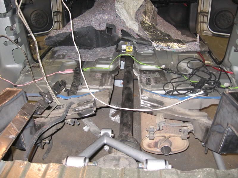

ok, sorry no new pics from tonight but i have some from yesterday.
yesterday we cut out the floor for the driveshaft and i started cutting out the fenders in the rear for the tires. then today we cut out the crossmember for the driveshaft and let it down lower, its laying a lot harder now but there is stil more cutting left.
heres all of yesterdays pictures
this kinda sucks but it wont be a problem
its a little lower now
looks bad ass bro....i cant wait till im bagged.
and some more little notes:
i gusseted my gas tank crossmember bars that i weled in and it made them a lot stronger and i also had to trim down the diff brackert because it was hitting the g-tank crossmember pretty good.
looks good how close were u to laying without the drop spindles?
it was laying inners and the front at the same time, but heavier on the inners. and ihave a smaller tire than what is on it in that pic with just the front bagged.

alright ive finally beenout there putting more time into it today. cut out the fenders and i measured the axle height from the ground with the axle all the way up into the notch and i will be able to fit a 245/35/20 with about 1/2 inch to spare so im excited about that. when i first did the notch i wasnt sure if i did it high enough to clear but now i know for sure. I pulled the front seats out and got the carpet moved out of the way, i was surprised at how much i had to cut for the driveshaft, i cut it even farther than before.
