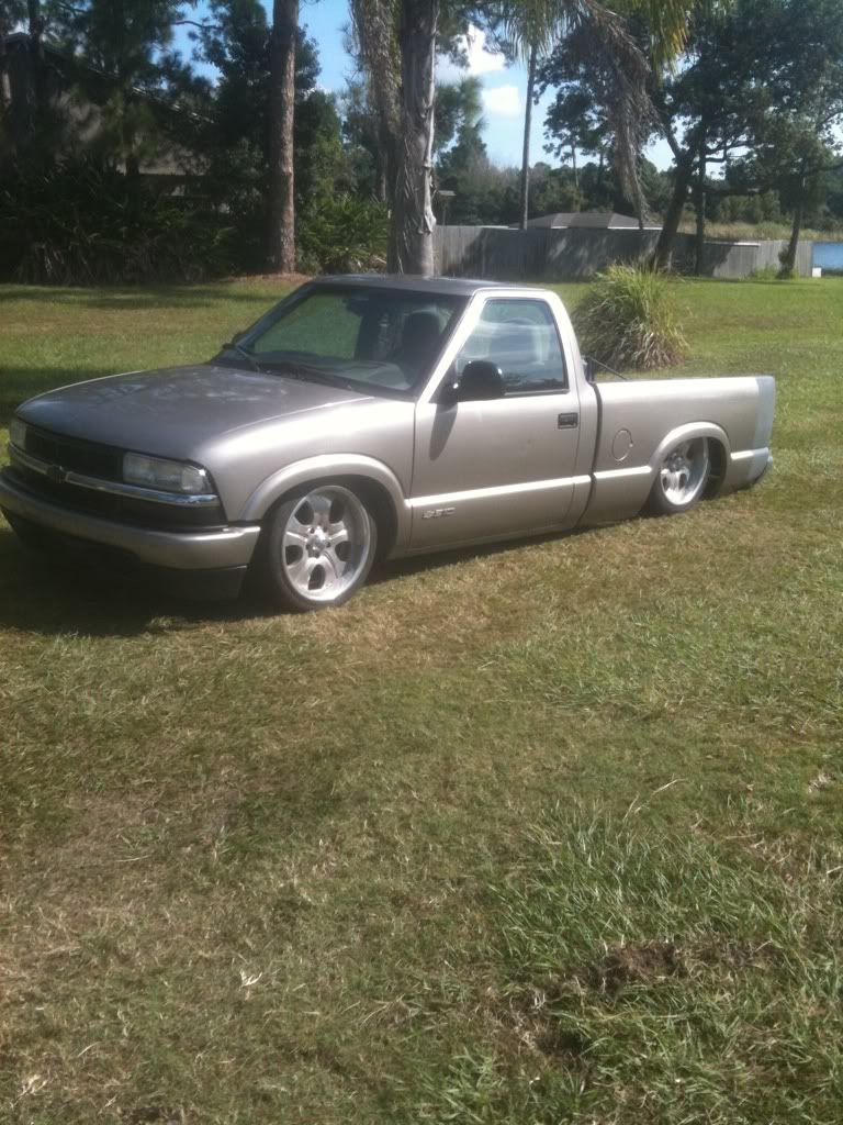

well i figured it was time to start a thread its called redemption because my first truck i ever built was an s10 when i was 17 and i ruined it lol did a horrible body drop and since then i have learned alot and owned and built alot of shit so i grabbed this s10 it was pretty much stock beside bagged with crappy 4 link and all stuck up front beside bags
plans are to bd it to the rockers and do a bag on bar 4 link

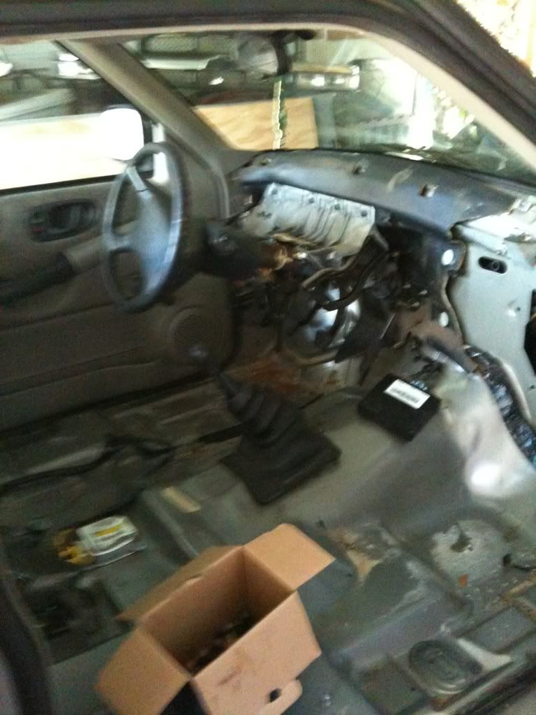

how she started off

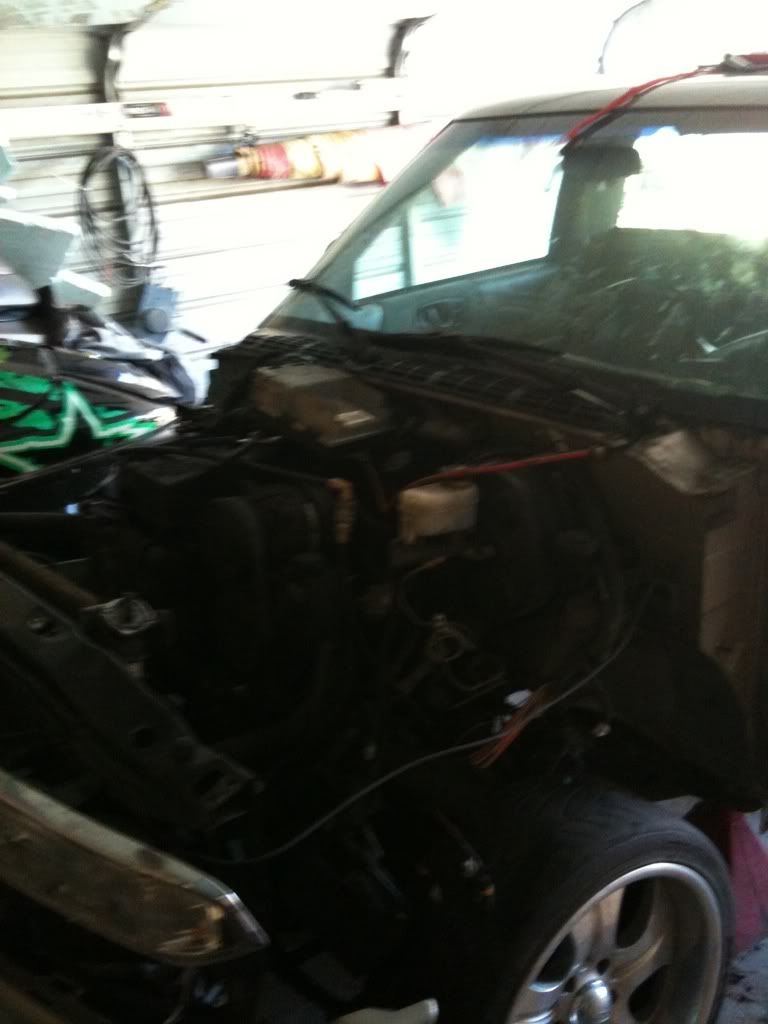

started to strip her

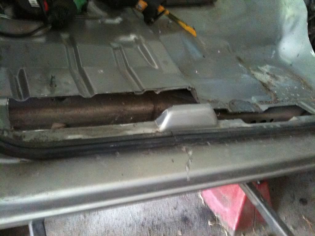

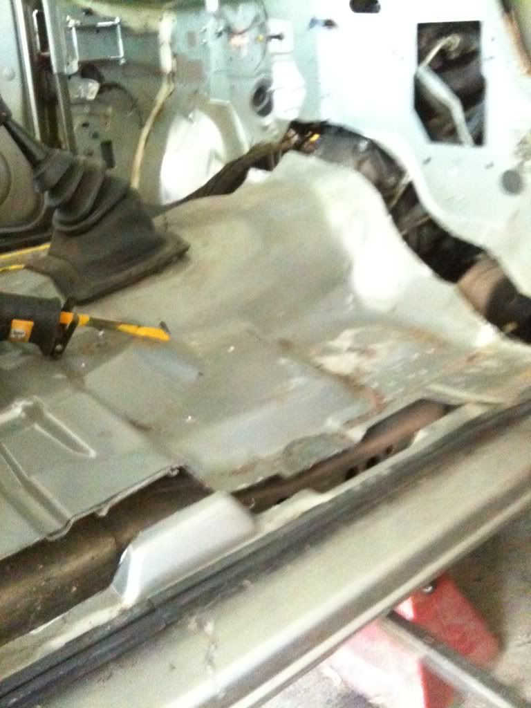

then got her cut out

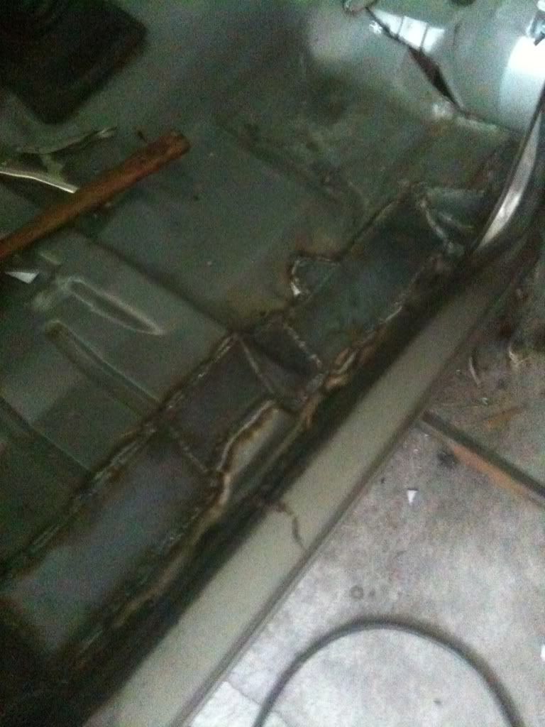

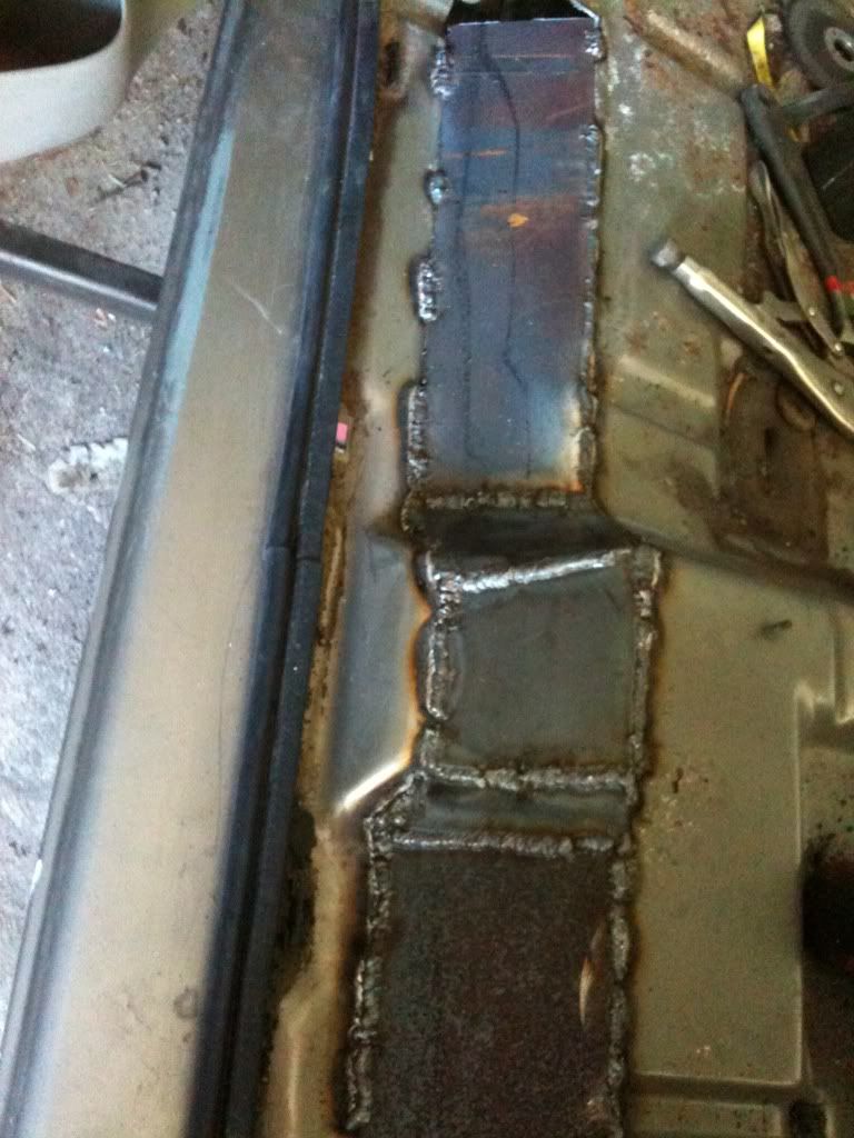

then started to weld her up

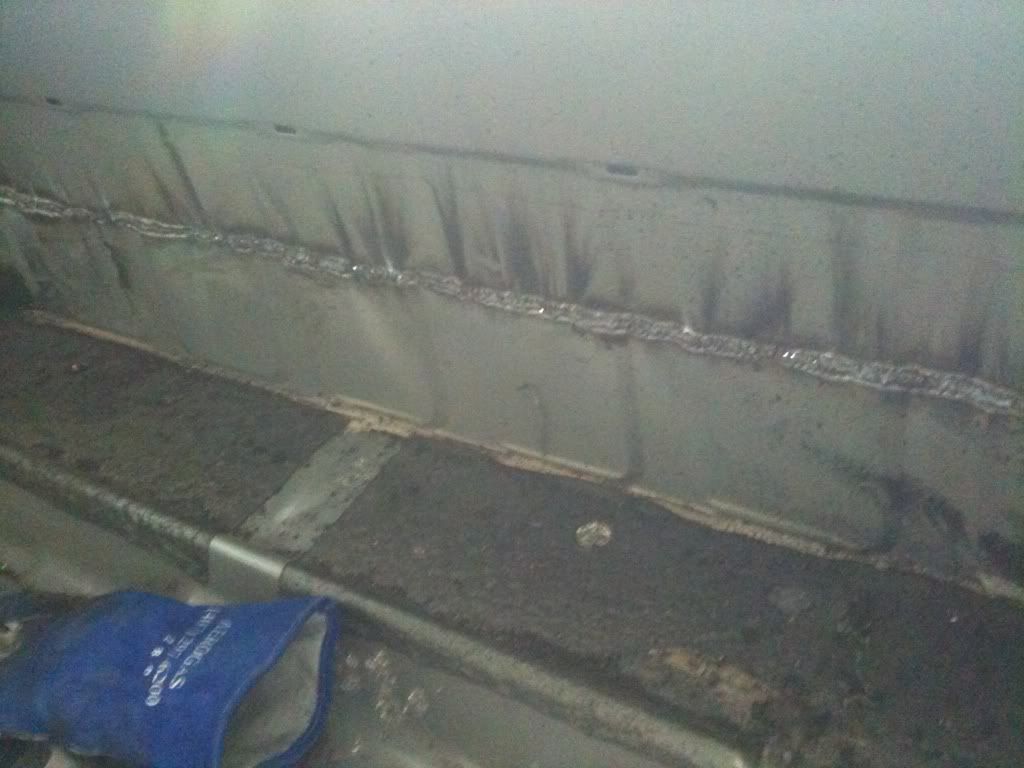

back wall
driver side
drivers side done
passenger side
thats about three day of work a couple hours a day got all the fire wall welded up besides the tubs started to tub it but since the truck isnt close to laying out im at a stand still... waiting for my mmw uppers to come in and gonna start de humping my lowers tom and maybe notch for the tie rods.. gonna try to make it lay stock spindles on 20's

didnt get much done today but cut the bars across the frame off and had to turn it around to start working on getting the front to lay and the frame horns cant really tub it till she lays out so i know how much to tub it
so i gotta radiator support and bumper off and pull the front suspension apart and dehumped the lowers gonna finish them up tomorrow and do the tie rod notches i hope my mmw 3 piece flat plate uppers come in soon he said two weeks and its bin about that
