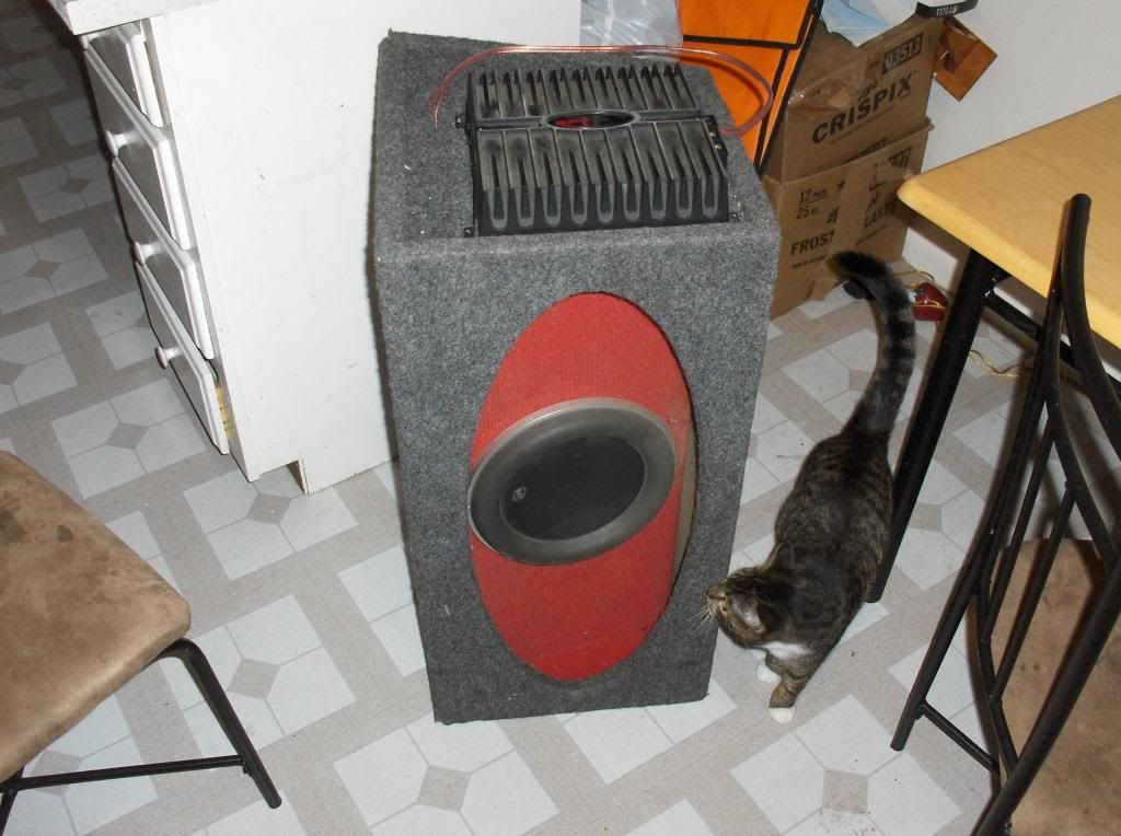

Also forgot I have had this laying in my kitchen too.
It's a lil bit of a brute. Should be right at about 750 with the 10w7s 3 ohm load.
