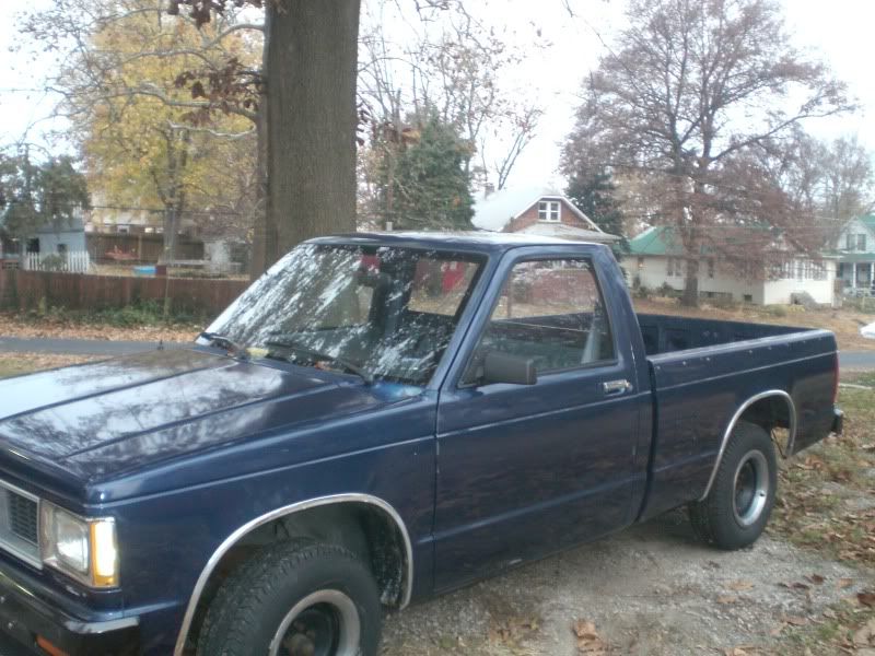

1986 2.5L Iron Duke with 114,000 miles.
here is what I am starting with.
I replaced the mirrors with new stock mirrors, as the others were junk.

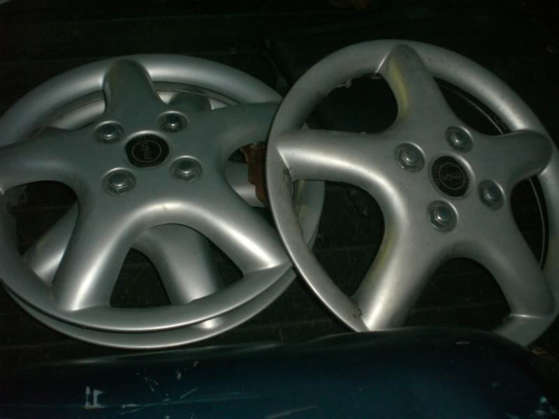

Pics of the old hubcaps
after removing the pinstripe, washing, buffing, waxing, replacing the hubcaps with the rings.
The front bumper is bent - I am replacing with a chrome bumper. Also looking to replace the grill. The previous owner had a snap tonneau, and as you can see the snaps are on the bed. I need to get those removed and filled. I got a friend that says he can do it, but I am hoping he can teach me how to do it instead of just doing it himself. There are a few spots that need fixed before I could consider painting - you can see the spot on the edge of the drivers door below handle. Like someone opened the door into a gas pump or something.
There is a deep scratch on the roof, and on the upper passenger cab corner, it looks like a tree limb hit it and it is dented in a little. The hood has the spot above the passenger side headlight, and the paint in the hood channel on the passenger side is gone. Other than those, the sheet metal is relatively scratch and dent free. (Keep it mind, this is a 1986 truck. Not bad for 24 years old).
