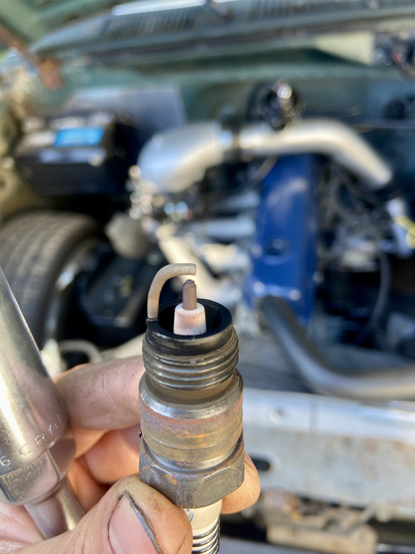

I was gonna replace the plugs today, but they don’t actually look too bad.
A little sooty around the threads, but the porcelain and electrodes are clean. I had plenty of other important stuff to get done to get it ready for a show next Saturday, so of course I did none of it, and instead messed with the interior a bit.
