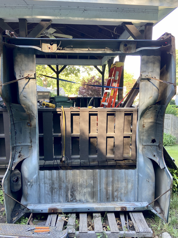

Spent the afternoon cutting out the bed floor and modifying and relocating the bedside braces so the bedsides weren’t all floppy. This also allowed me to push the bedsides out about 1/2”, allowing a little more tire clearance when laid out. I ran out of motivation and started getting cold feet when it came to hacking the wheel wells. That’s tomorrow.

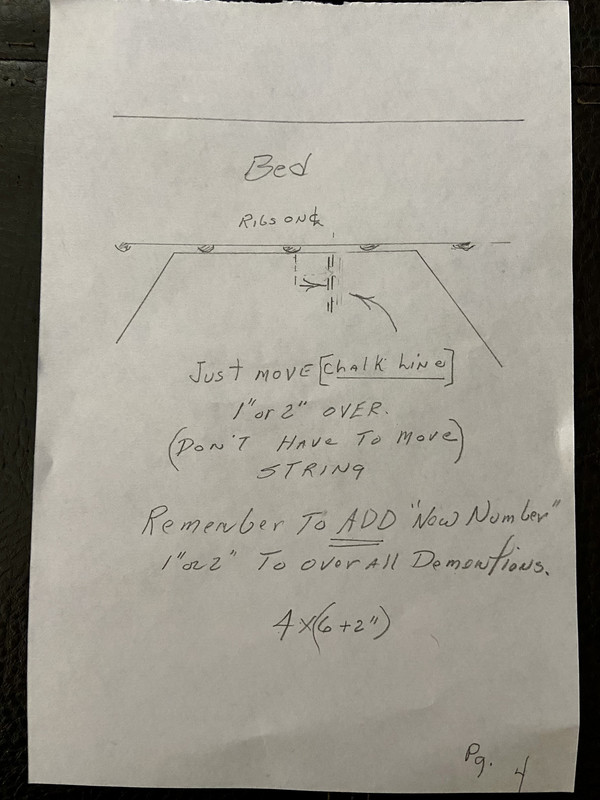

For at least the last month, at least a couple times a week when I’m out working on this turd, my 70something year old neighbor Jack comes over to check it out and chat. Last weekend, when I got the air ride done, I showed him how it worked and blew his f’ing mind. He came over a few days ago and spent about 20 minutes taking pictures and filming me playing around with it.
He had some pretty neat ideas for the bed.
He put waaaaaaaay more thought into cutting out the bed floor than I did. He showed up with these drawings right after I cut it out. I could tell he was a little bummed he missed it.
He put all the pictures and video onto a CD for me, too.
Definitely nice to have a cool old guy for a neighbor.

Still not low enough. Gonna have to body drop it. I need to get some trailer fenders to cover the rear wheels. I don’t like it being wide open like this.

Not really. The bed rails are still intact, as is the crossmember at the rear. And the brackets still keep the sides from flopping around. It is a hell of a lot lighter though. Probably by almost half. Adding tubs will strengthen it back up a bit.
