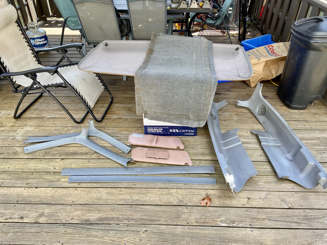

Finally grabbed all the rest of the interior that my truck didn’t come with. Headliner, A and B pillar trim, rear wall carpet, and a pair of very faded but fancy upholstered visors. I’ve been looking for a while, and not finding anything for 80-86 trucks. Went to a new yard this morning, knowing they had at least a few of these. None had this stuff. I think only the top of the line models got it. So I went back to my usual yard and grabbed it all out of an 87-91 truck. I knew the B pillar pieces were different, but figured they’d still work.

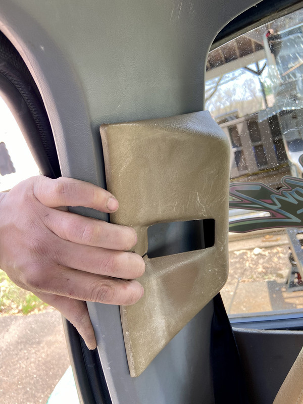

It wasn’t till I got home that I realized how different they were. The seatbelt tensioner in the 80-86 trucks is mounted up top, but on the floor in the newer trucks. So there’s a bulge and slot on the bottom of the newer panels. It’s mostly hidden by the seats, so I’m not worried.
What I do have to deal with is the part around my tensioners.
The new panel obviously won’t fit without much cutting. Plan is to cut out just enough to get it over the tensioner, then mount the original trim over it.
Everything obviously needs to be painted the correct color. I ordered another couple cans of SEM. I’m not sure if I want to go through the hassle of stripping this headliner and finding the right color material, or just dying it. There’s a couple really small holes, but it’s otherwise fine.
