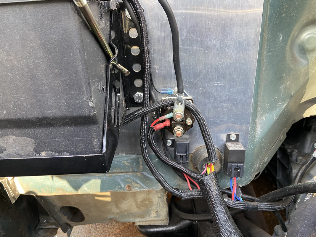

Maybe not major progress, but I got the starter solenoid mounted and just about all the wiring done.
Miraculously, both battery cables ended up being the right length without any planning or measuring when relocating the battery.
Still need to secure the wires to each other and the firewall, and make a new, shorter wire to the starter, but it’s close. I turned the key on and everything works and nothing caught fire, so I’m impressed.

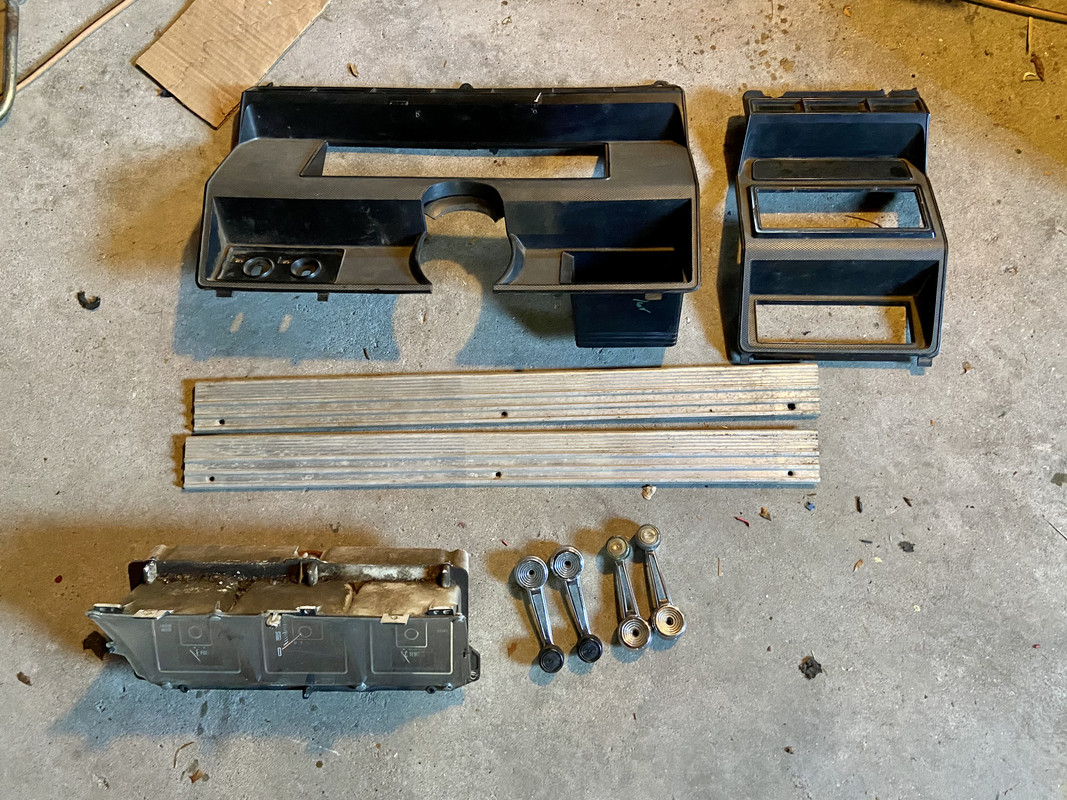

Got another set of dash bezels. They’re kinda rough, but undamaged gauge bezels go for ~$100, and radio bezels are $50-75; I paid less than $10 for the pair. So I’ll make a profit no matter what.
A couple pairs of window cranks. I was thinking of swapping mine out for the black ones, but the chrome is kinda rough, so probably not.

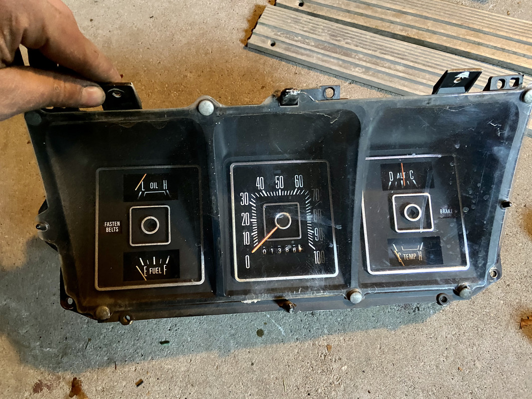

A gauge cluster from a 74-79 truck. No use for it. It was just sitting on the floor of the truck, and I like the look of it. I’ll sell it for 100%+ profit.
And, what I’m excited about, some aluminum door sills. The driver side in my truck is all jacked up from the previous owner trying to screw it down to the rotted out floor. They just need a good polish, and they’ll add yet another touch of class.

Make sure you leave enough room for your screwdriver to jump that solenoid! You know it’s only a matter of time.
