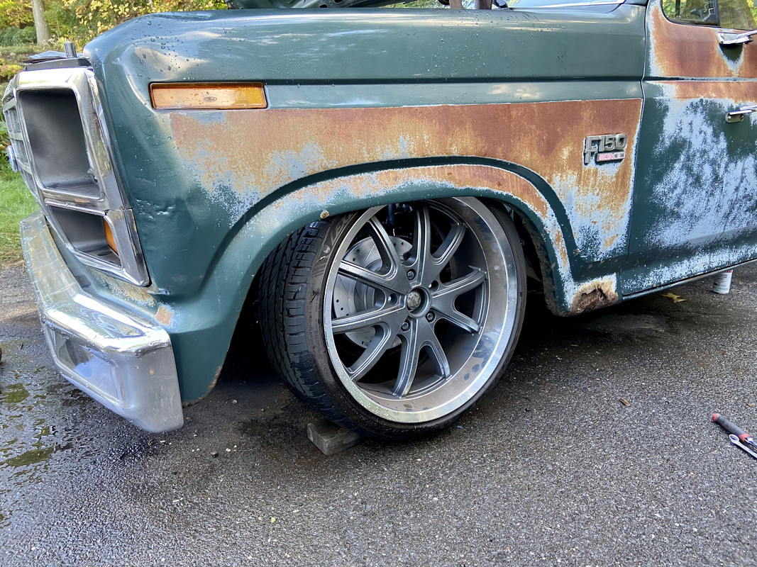

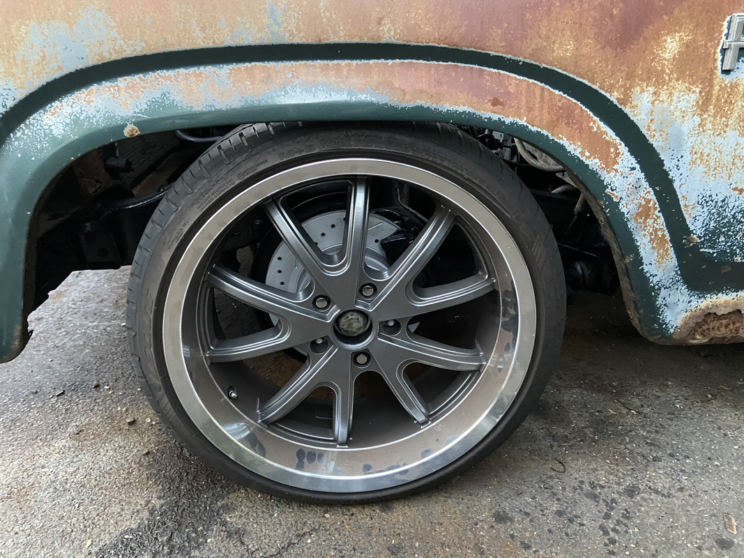

Well, it’s been a week of setbacks and disappointment. I would have had everything done and wheels on last Saturday, but the right caliper was no good and the piston wouldn’t push in. Nowhere had them, so I ordered them Monday and picked them up Tuesday. Got them installed Wednesday. Had to practically hammer the right side on. Caliper was correct, piston was all the way in, so the only thing I could figure was my new ‘performance’ pads and/or rotor were a hair too thick. So, yesterday I took my palm sander to one of the pads for a minute, and got that all back together and the wheels on. Set it on the ground, and...
Not any lower than it was static. Went back out this afternoon and pulled the shocks.
That was it. They were close to bottoming out before, and the upper mount on the bag brackets is about an inch and a half shorter than the stock mounts.
No one really seems to make a shock that short. And I don’t want to spend even more money. So I’ll be modifying the radius arms to mount them lower.
Right now, fully lowered, the bags are actually what’s holding the truck up, which is no bueno. Pull them out, and the truck drops another inch or so. Plus, like I showed, the angles are super funky. So I’m gonna pull the lower brackets and chop them down and see what happens. I can only shorten them about 1” max, till they touch the upper balljoint. It’ll help, but it’ll still be resting on the bags. Sorry for the novel.

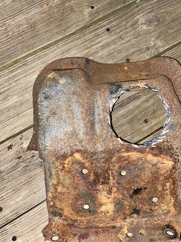

Oh, it’s pretty much been fingered. Just haven’t posted yet. Chopped the arms up to get the shock mounts lower.
Of course moving the shock mount to the bottom ended up being too far, and the suspension wouldn’t even extend far enough to get the bags in. So, I just drilled a hole about half way up, got some grade 8 hardware, and it was done.
The shocks max out about 1” before the suspension is fully extended, but that’s fine.
Next issue was the bag mounts. I’ve been procrastinating on this a bit, because if I screw them up, I gotta spend another $180 and wait 2-3 weeks for new ones to get delivered. Last night I finally just did it.
I’m taking 3/4” out of them, which will bring them down as far as they can go before they hit the upper bjs. I’ll get less squish on the bag, and I’ll tweak the angle slightly to make the upper and lower closer to parallel when fully compressed. At least, that’s the plan.
