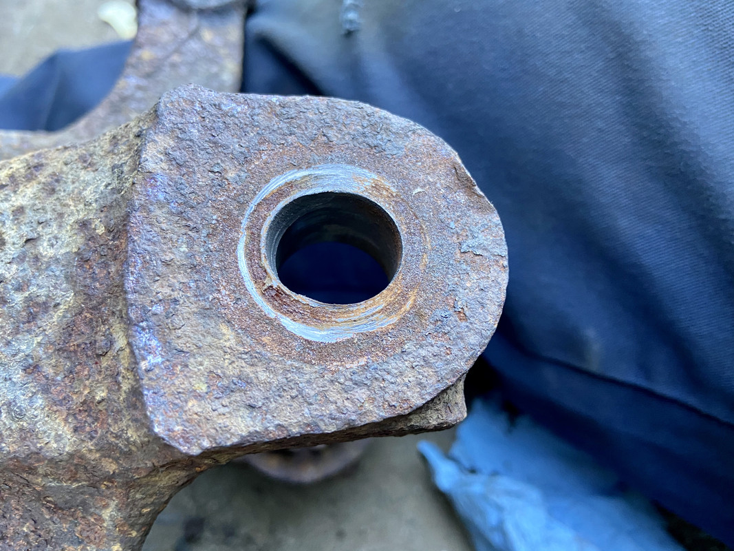

Got the brakes pulled off, and the right side spindle. And saw this...
Lower balljoint hole is egged out. I had trouble tightening the nut when I first lowered the truck a couple years ago. I thought I finally got it; the nut tightened down and there was no play. But I guess I didn’t. Unfortunately only an 85-86 spindle will fit, and nowhere within 75 miles has one. I might take a trip to the other side of the state Saturday if the junkyard is open. Kind of a bummer, but oh well.

So I ended up not wasting time trying to get that balljoint nut off. I just cut it off and pressed in two new lowers.
I test fit one into the right side spindle, and I’m not gonna need to replace it. It’s only egged out at the bottom where the threads sit. So that got cleaned up and painted.
