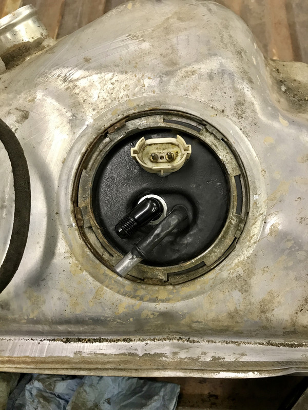

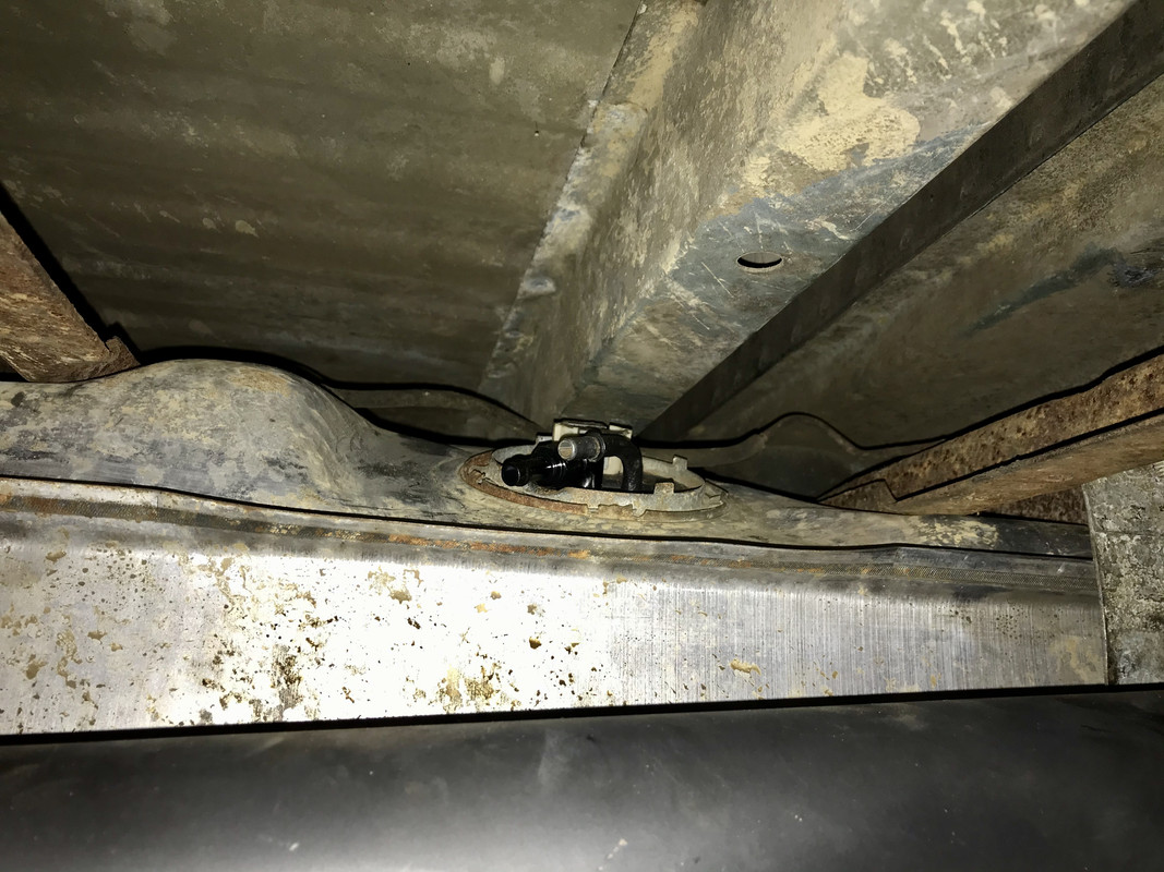

Got the return tube on. Had to heat and bend it to clear the float arm.
Installed, FACING THE RIGHT WAY! The stock fuel line ran up the driver side frame rail, but the sending unit nipple faces the opposite direction. That’s good for me, since the new fuel line will be running up the passenger side.

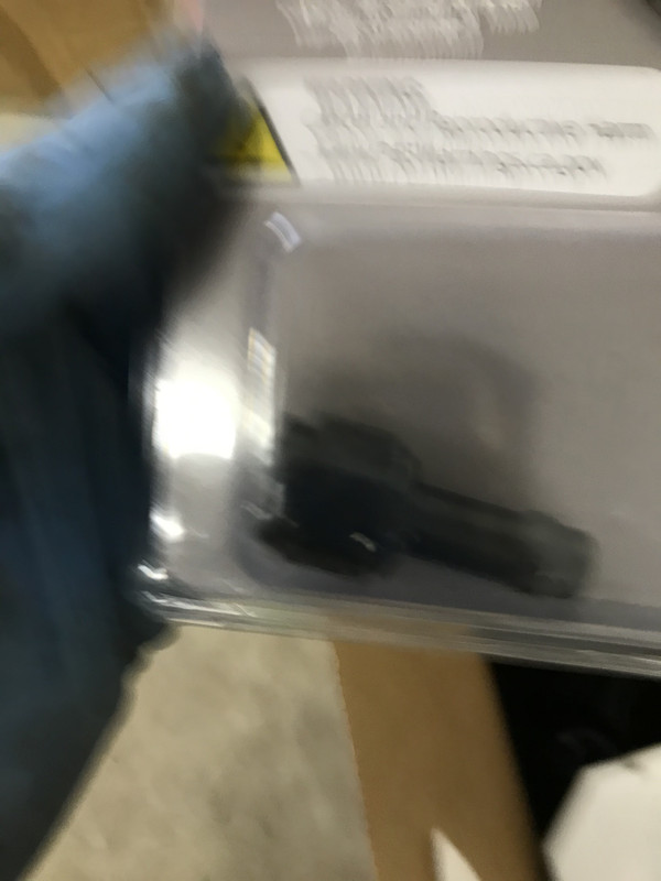

And that’s as far as I got, because this stupid kit doesn’t actually come with enough fittings to do what it’s supposed to do!! I needed 4 of the -6 to 3/8 hose nipple fittings.
Kit comes with 3. The more expensive kit comes with 4. WTF Holley?!
It ends up working out, though. It’s gonna be a much nicer install if I run 90° fittings off the TBI instead of big loops of hose. So I spent another $25 for 2 90° fittings. They’ll be here Thursday. Hopefully have it up and running next weekend.
