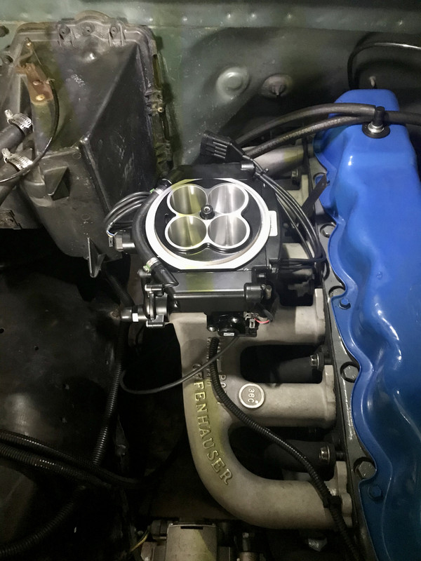

Finally starting on the EFI swap! Got the carb pulled and EFI set in place.
Looks so good! Carb is already listed on Craigslist and Marketplace.

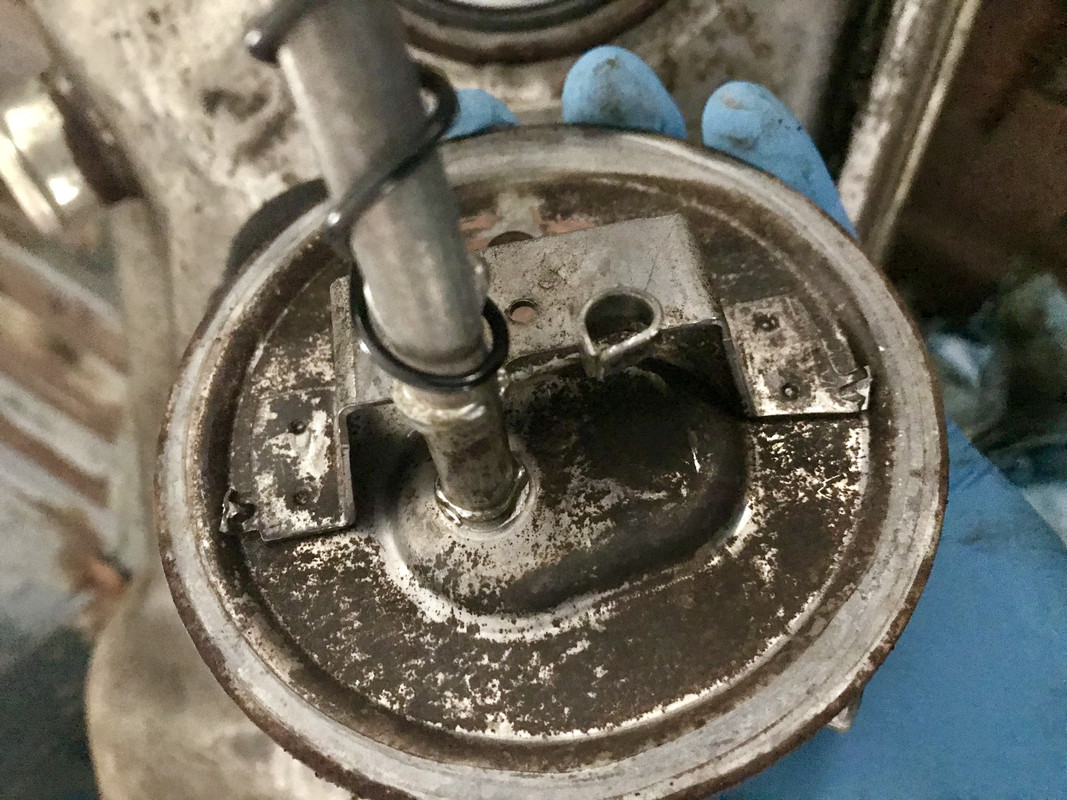

And I know why my fuel gauge was so messed up.
Last owner put a new tank in it, but reused the sending unit.

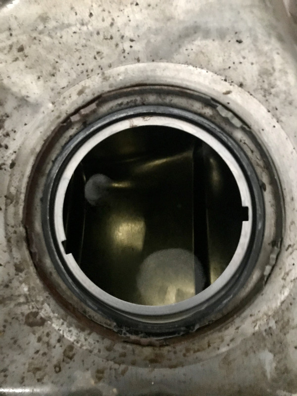

See the two little notches?
And what’s left of the two little tabs?
For whatever reason, the genius previous owner decided to break them off and put it back in upside down.

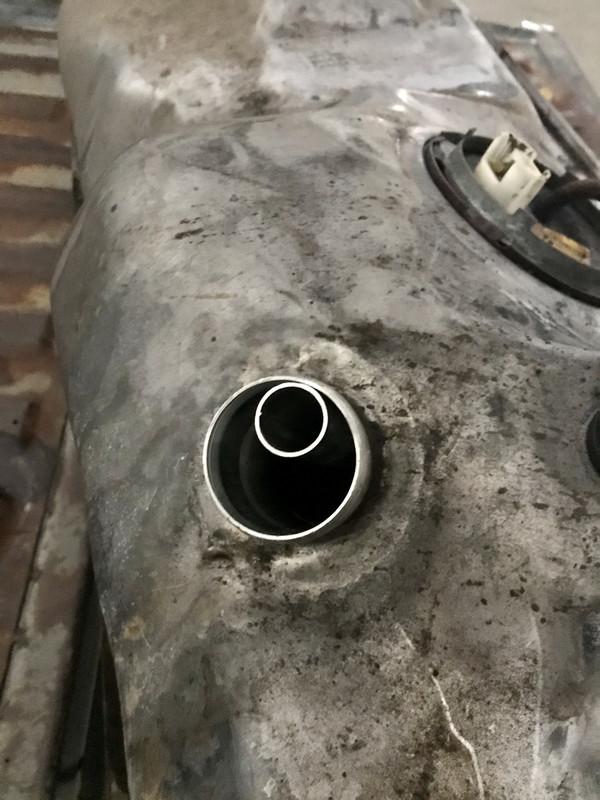

Same type of deal with the filler neck.

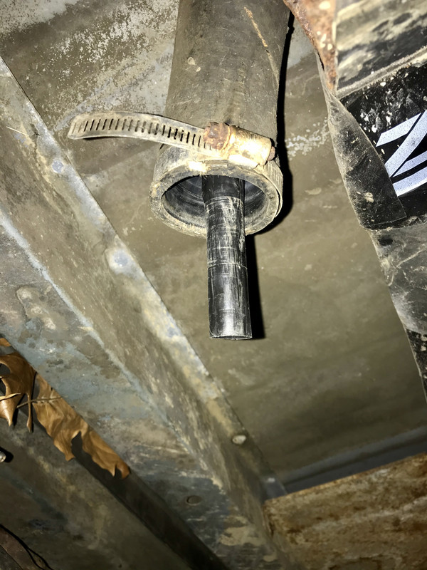

This vent tube is supposed to go into
the small hole. It was just pinched off to the side.
I’m gonna get a new sending unit. If I can find one. Rockauto is completely out of stock, and the couple parts store websites I checked don’t even list it. I’m sure the guys at NAPA will come through like always. Once I drill and add the bulkhead fitting to the new one, it’s just a matter of running the fuel line, pump, filters, etc. and wiring everything up. Oh, and adding an o2 bung to the exhaust. Should be up and running in no time!
