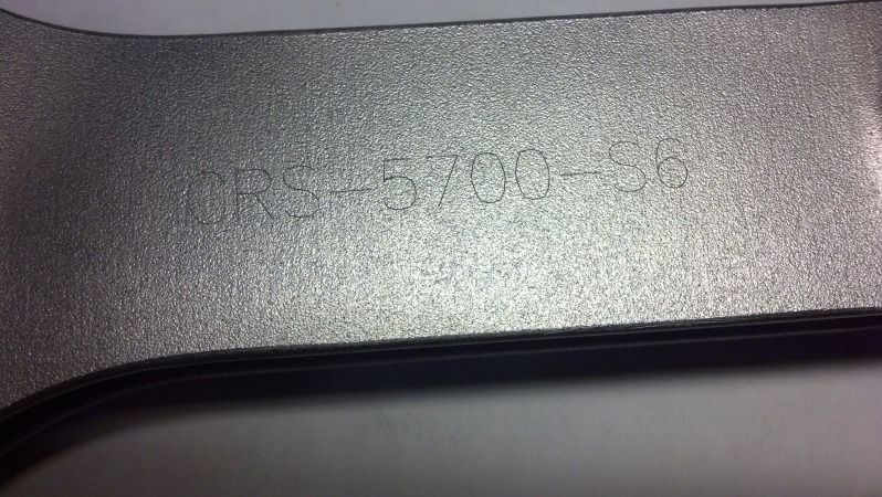

I hope I am not stuck at this point for long. The rods came in the other day and wouldn't you know they sent the wrong ones. They were for a 350 and not a V6. Gonna start ordering the little things that I need to replace so it doesn't all hit me at one time. Also found out some of the cab bushing are gone. We couldn't even get some of the plug to pass through the body/frame from the O2 sensor so that is something else to replace.

Dropped off some main studs to the machine shop and they are just about done. Rings and bearings were delivered today. Rotating assembly is balanced. He said they had to add some heavy metal to the ends of the crank because of the weight of the Eagle rods. Heads were cleaned up and gained some flow.
