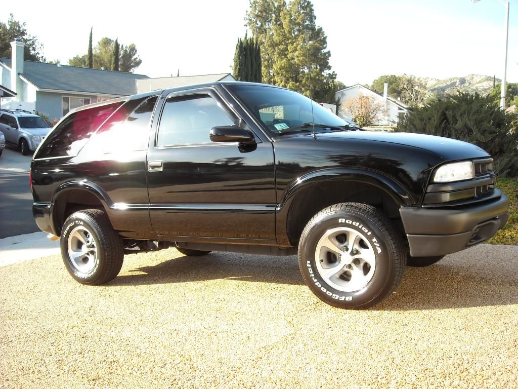

I bought the truck in march 2007 when I was a senior in high school, I bought it bone stock off a dealer lot (back in Boston where I'm originally from) it was a trade in it had about 64,000 miles and I bought it for $4500.
Unfortunately I don't have any pictures of it stock but this was the first "look" I had. 2" lift shackles, with stock size bfgoodrich radial t/a's, custom y-pipe back 2 1/2" exhaust. (Lou's custom exhaust ss signature series muffler). Street Scene Mirrors. East Coast Customs roll pan.

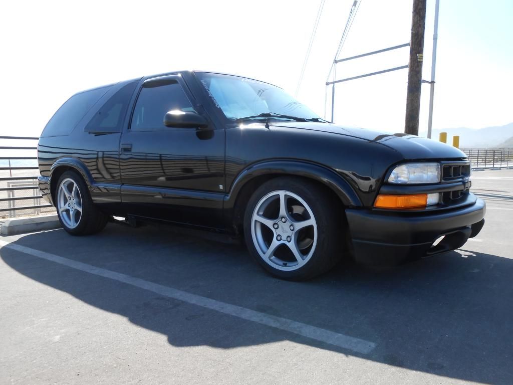

After almost 2 years I got really really sick of the sawblades, and they were heavy. Decided to change things up with some of the lightest corvette wheels, C5's little did I know these wheels are actually so thin that were prone to cracking with the oem runflats that's why they changed the design in later years.
15
One of my best point and shoot shots with the C5's, out in santa monica, note the GM mark of excellence placement, serendipitous.

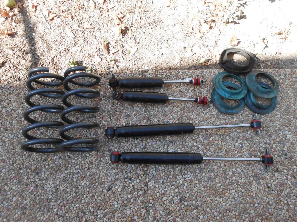

I was all ready to do qa1's then moon listed strong arms for sale in the suspension section, I pulled the trigger and never looked back. Single adjustables with 850 spring, this is how they come out of the box.

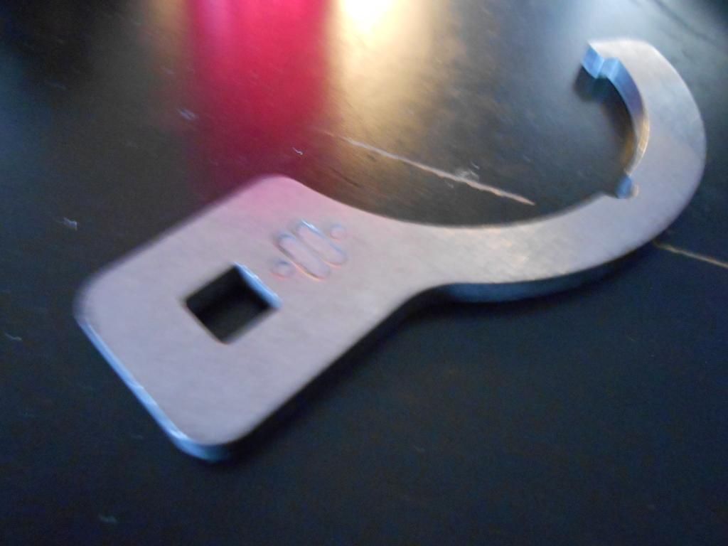

Putting the catch ring on without scratching anything was hectic.
All assembled.
When ridetech does the hq rear shocks they flip the orientation so you can reach the adjustment knobs.
Sexy Bitch.
The talked about upper spring perch material you have to trim for clearance.
In this pic it looks like its still close but the hole is actually far above the spring.
Yes I actually stuck an angle grinder with a cut-off wheel on it up into the spring pocket. Luckily by now I was a magician with that grinder.
Going back together.
Giving you a better idea of how it mounts.
Finito, with the shorty endlinks. Setup on half stiffness 12 clicks for break in period per ridetech instructions.

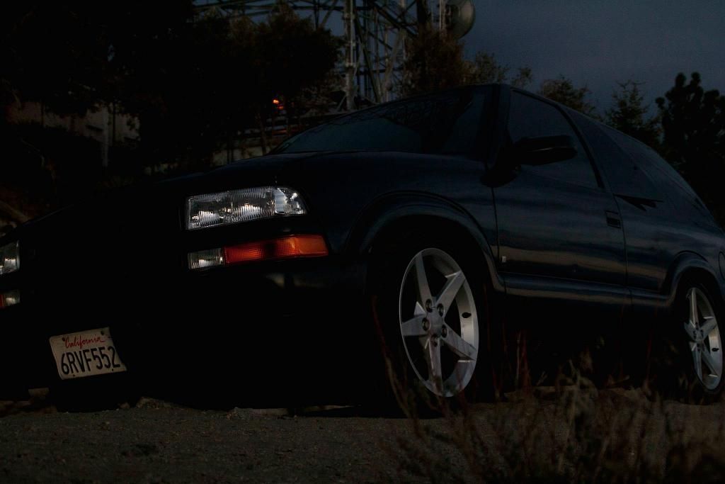

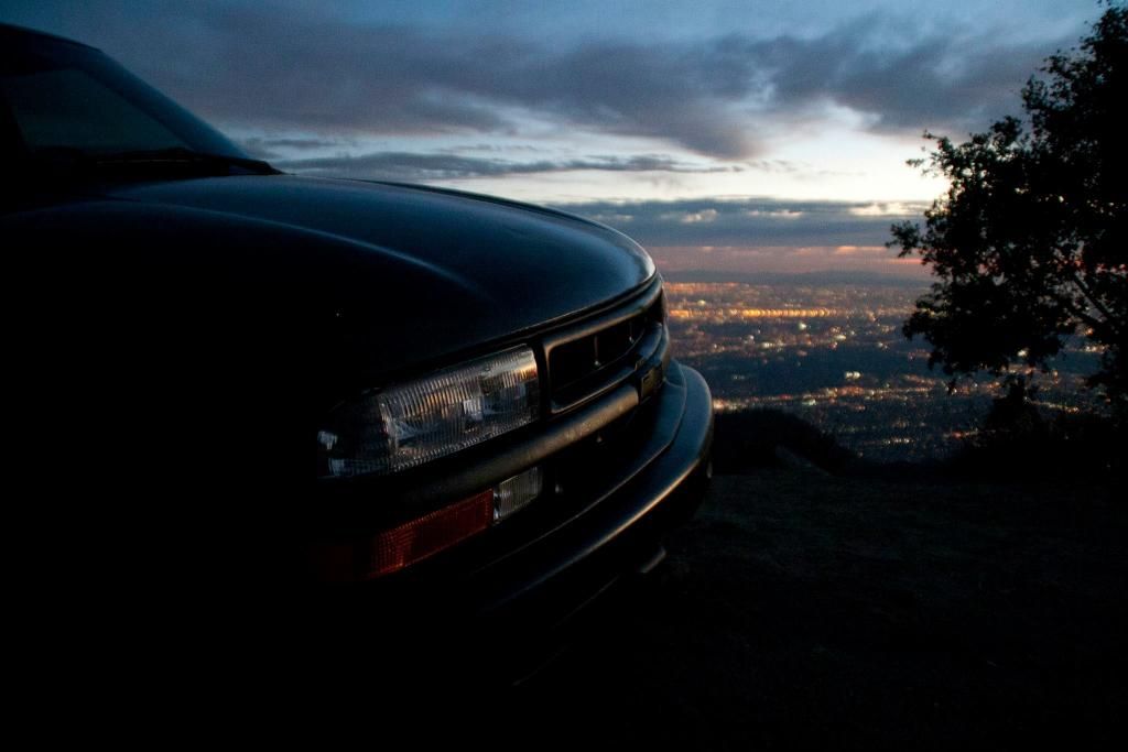

Ok here we go with the pic whoring/ photoshoot with the new wheels.
This is at the top of Angeles crest highway overlooking LA.
Just officially submitted my application for trucking throwdown 2015 with these pics! No v8 but eh, wish me luck!
