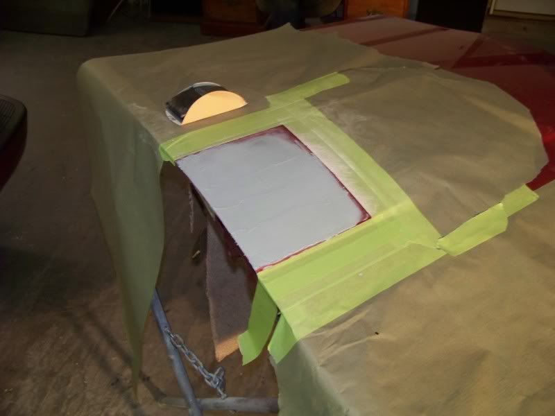

I'm doing this Astro for a customer. Cadillac tail lights, shaved door handles, suicide driver door, escalade front end conversion. It has a 2/3 drop, and he has 20's for it.
Pics of progress so far.
Progress should be fairly quick on this, so check back soon for updates.

good progress, but why do people insist on putting hardlines with primer when shaving stuff?

I have to disagree with this. The primer will hold more solvent when the base coat is applied giving you a swelled spot on that line. Also when sanding out the hard line it is very common to cut through the clear coat and leave a ring or asshole when painting.
You're masking it either way...why not just roll the edge to give a soft line? Or even balloon your paper and hit it quick to get rid of the overspray?
