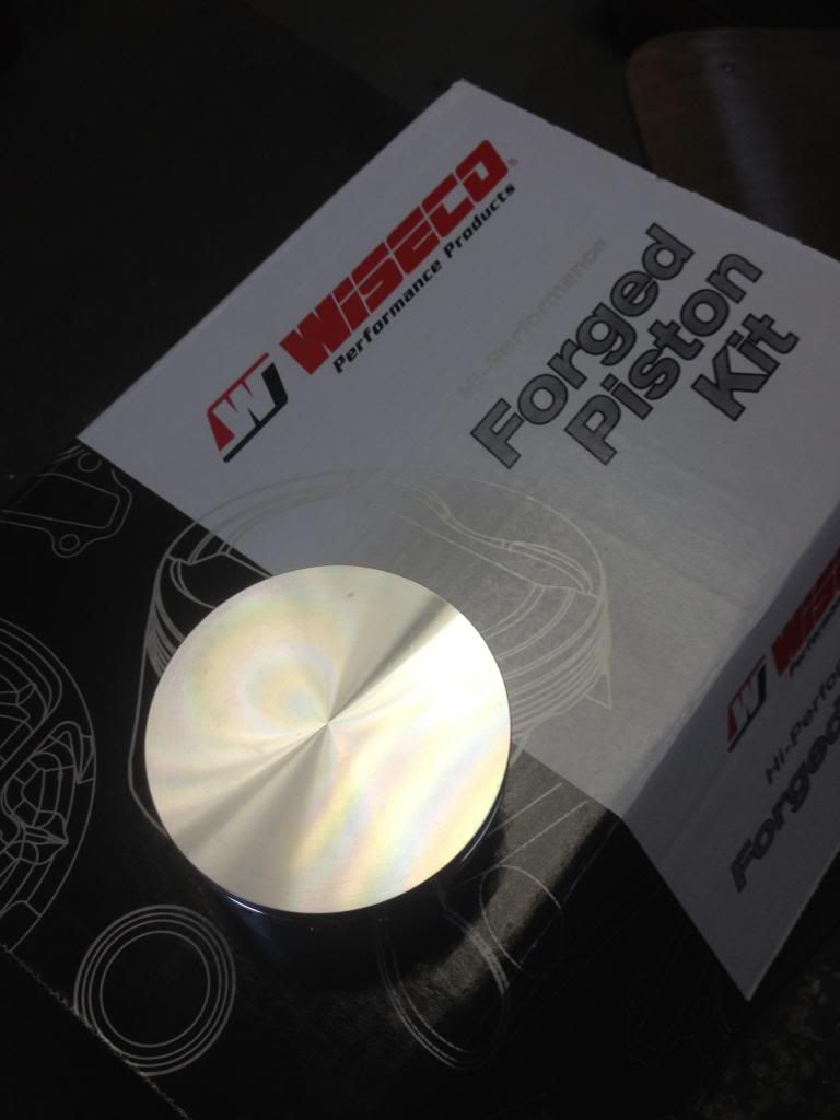

We then got Wiseco 10.5-1 compression flat top pistons (almost too pretty to put in the engine IMO)
