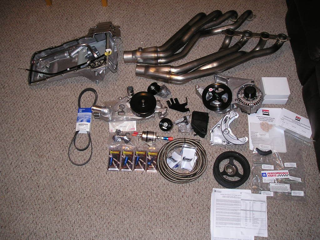

What you are looking at:
H3 hummer oil pan, tray, pickup, dipstick GMPP
Vette fuel filter/regulator Delco
Ls3 complete front accesorie drive GMPP
Stainless Works 1 7/8" longtubes
Holley high mount R4 compressor bracket
Various -6 fuel shit

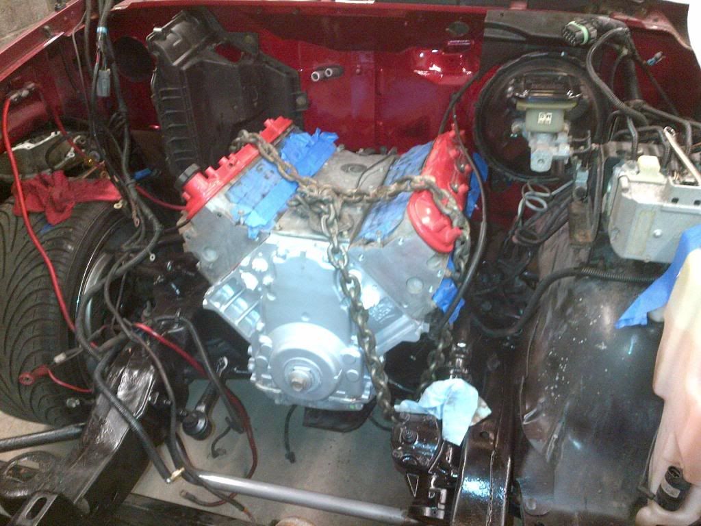

Got the engine and trans out over the weekend! My harness, mounts, and cpw rad are now here it all looks really nice.

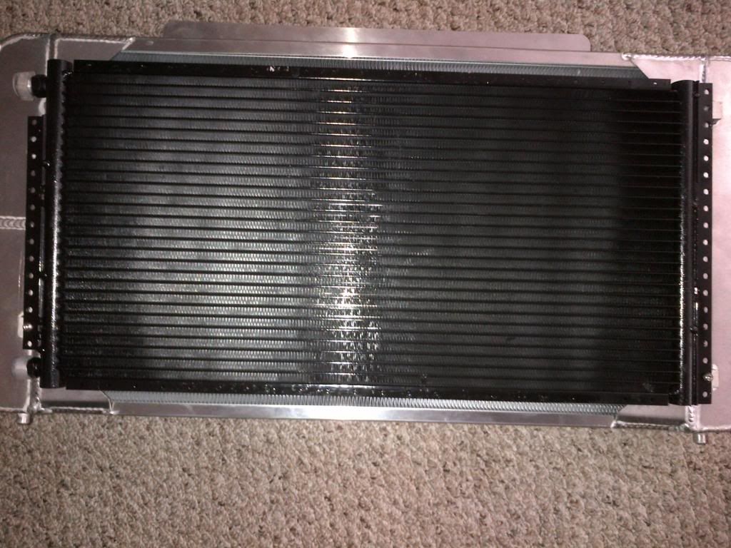

Did your cpw harness come with any instructions? Have a few plugs not labeled, i'm sure i can figure it out.
What year clutch assemblies will work for my truck? Its looks like the master cyl mount bolts in on 94's, but 95's appear to the push and turn style. Are the pedals diff 94-97?

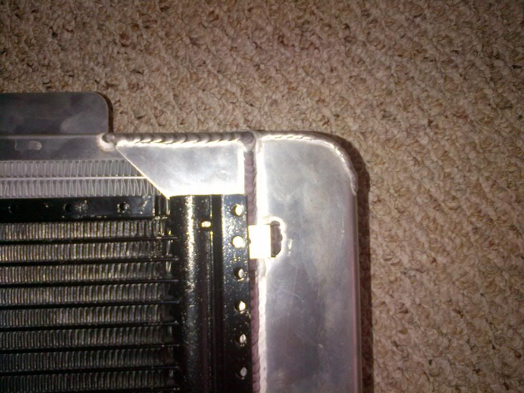

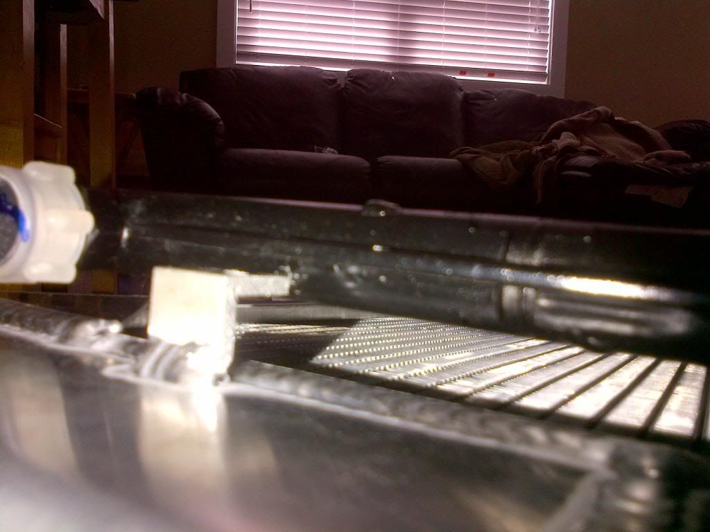

I don't think the condenser is made to mount up to the radiator, far as I know the radiator goes inside the core support, and the condenser goes outside, between the core and hood latch. I think the CPW kit comes with a new lower side of the hood latch to clear the condenser.
You might call and ask on that one though.
That is a CPW setup right? Sure looks like one?

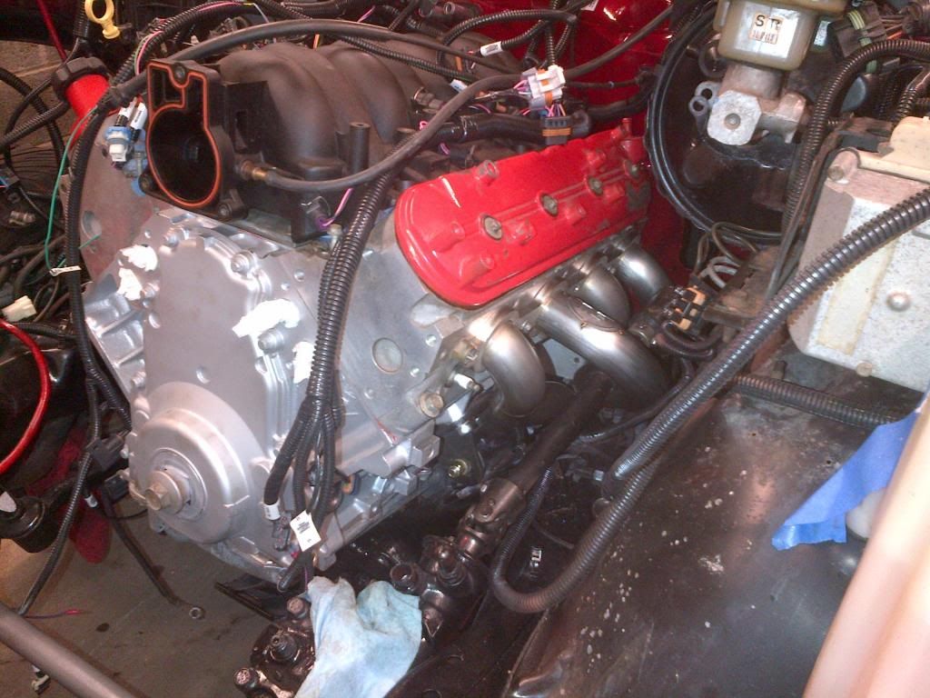

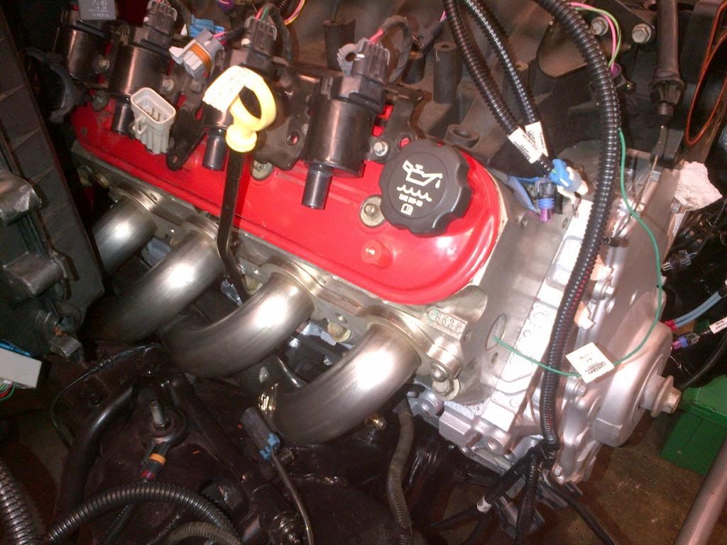

So the BRP trans Xmember is a pos. It hits the trans casting before it fits in the mount, the holes were not drilled straight to line up with drivers side frame holes. Also my SW long tubes are touching the body on the pass after a ton of beating. The motor is set 1/4" back so idk why they are soo close.
