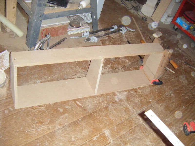

building a new enclosure as of well, yesterday morning now, ive got the top, bottom, and sides/divider done, each chamber will end up being about 1 cubic foot, just putting my ultra linears back in for now, but im planning to swap them out for the dayton HO 12s, which is more what i am designing the encloseure for, includeing the cutout diameters

all of my joints are dadoed/rabited and glued some of the pieces split a little, but the glue, caulk and the high likely hood of me dado/rabit jointing the baffles to it really shouldn't matter, but i did learn the lesson to ALWAYS predrill my holes

those things rock, ive used them, but they are really best for when you want to sink the screws deep and fill the top with a plug to hide them
