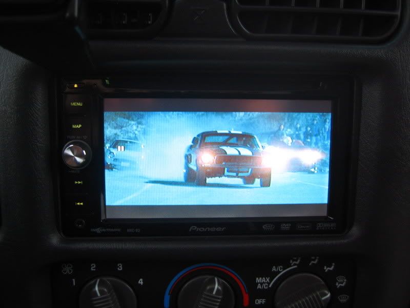

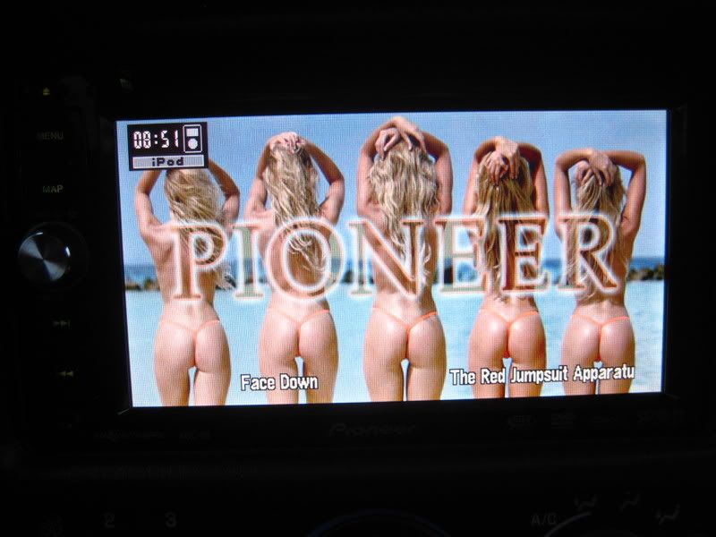

DVD Playback:

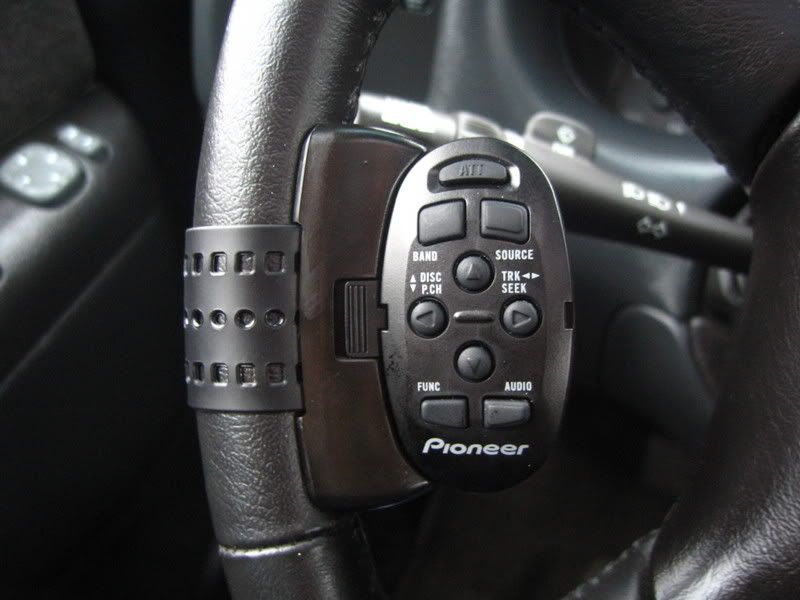

Wireless Steering Wheel Remote:

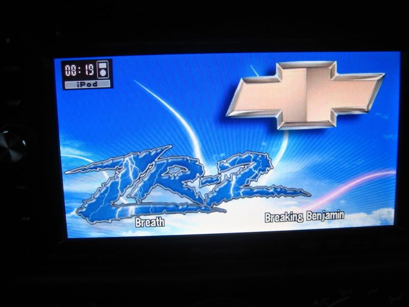

Customizable Backgrounds:
