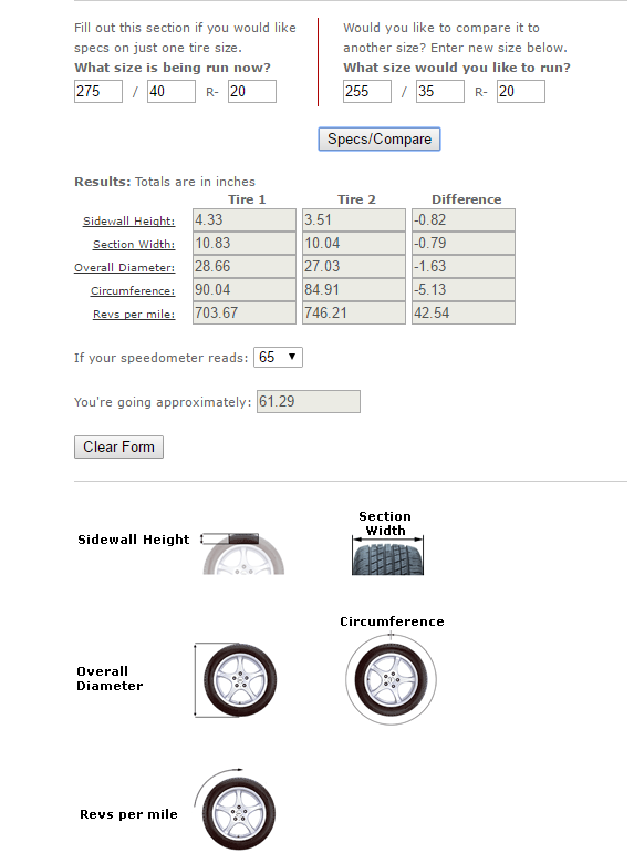

This picture is with the 245/45/20 front and 275/40/20 rear.

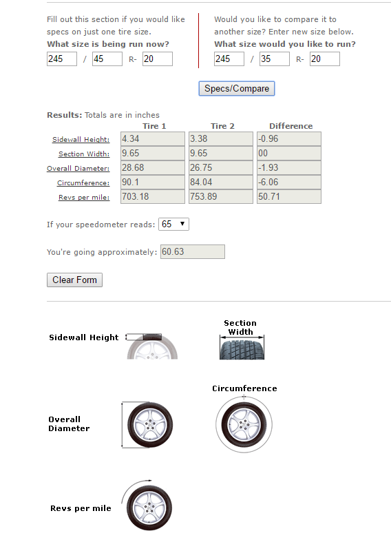

Using HyperTech programmer for speedO correction.

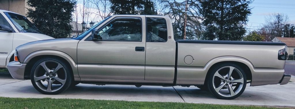

Here the picture's with the 245/35/20 front and 255/35/20 rear.
