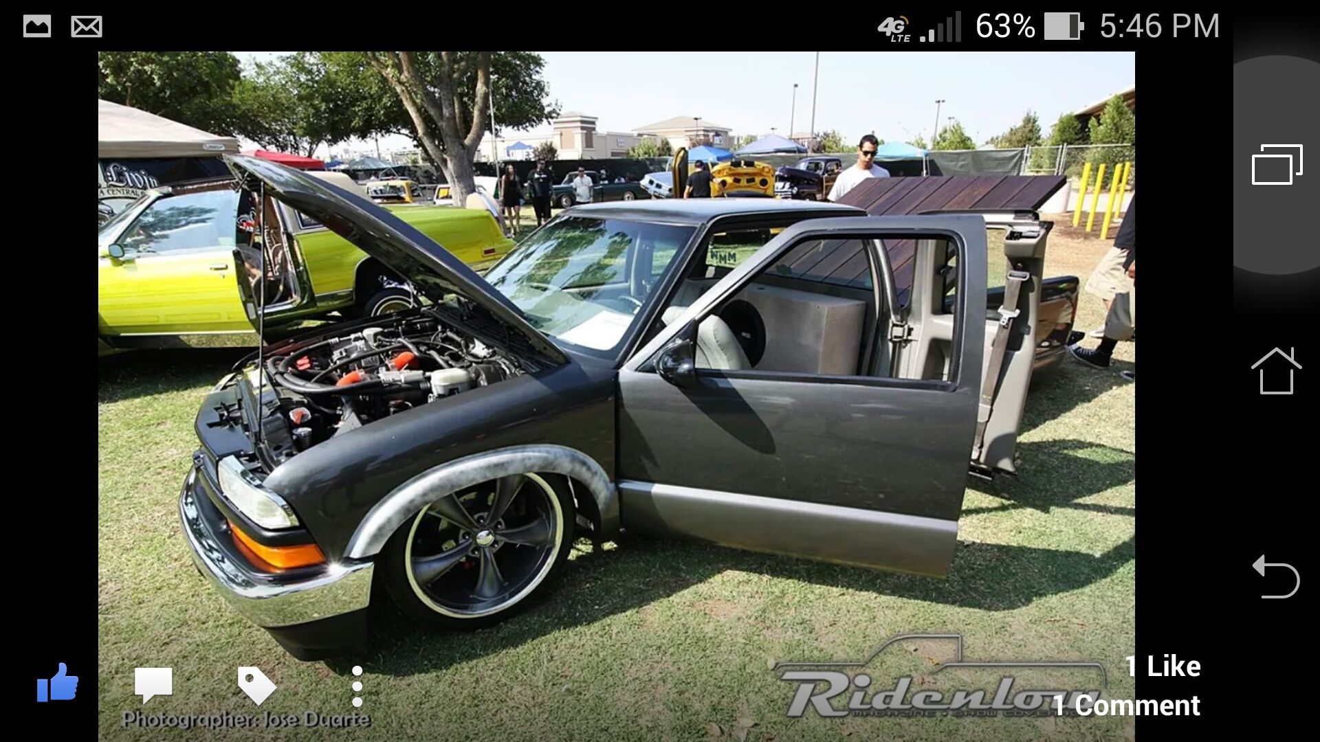

Discussion Starter · #1,670 ·
pic of my truck from magazine shoot of car show Saturday ....( they poste on FB and I took a screen shot of pic )
